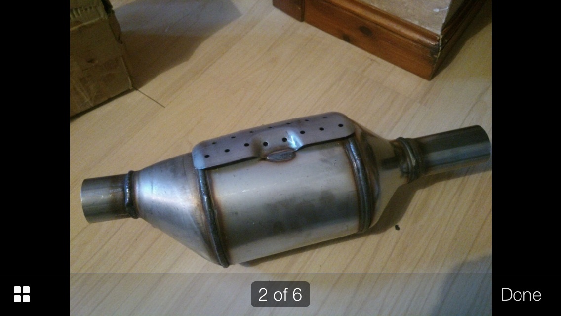

I paid £150 for my DPF deleted downpipe and dummy DPF. That was custom made by a power flow exhaust place.
82BB648E-3D7D-4A01-BB50-276E1BDAF340_zps
CABA2537-3691-4A71-84E0-771174E0943A_zps
AC60B1D6-9720-4001-9CB1-91B9D6BDC11E_zps
Have you had an mot with that dummy dpf mate? That's the only thing that would worry me now
No but ive asked a few garages who said it would 100% pass. The main reason was because they cannot prove its not a DPF.

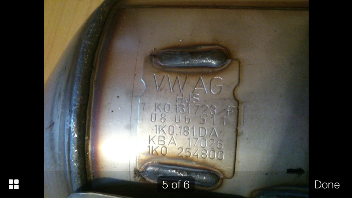

So would I buy this and still keep my original dpf? Obviously this would be handy in case any changes come in with the mot. Was that just supply or was that fitted?
If it has filled up with ash you could look at getting it cleaned.
Yep, this is the cheapest unquestionably-100%-legal solution.
