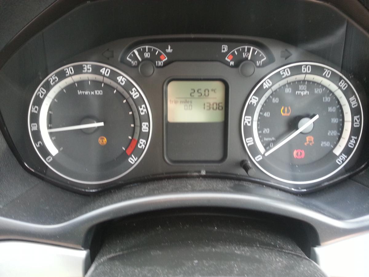

I have just finished fitting a K&N induction Kit to my 06 Oct vRS and when I have started the car I am getting the attached lights lit up on the dash
ESP won't turn on and I'm not sure what the Steering wheel icon is for, Can anyone help please?
Thanks!
Edit: Forgot to mention I had to disconnect the Negitavie terminal!
Go for a drive that will clear.
Normal when battery disconnected
Battery off or low? I had them the other day after working on the car and letting the battery run down. Quick blast and it's all fine.
Thanks for the advice, all is working (all lights are off) after a short (not so short) drive.
I think I should have read the manual, read it after posting on here and it said the same about a short drive after disconnecting the battery!
