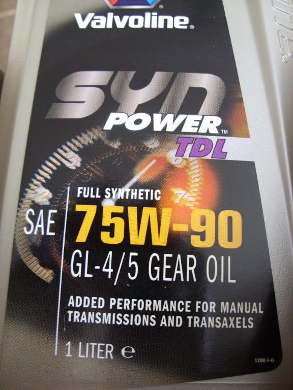

I think gearbox could do with some new oil too - what oil is required.

See attachment: for gearbox oil..
