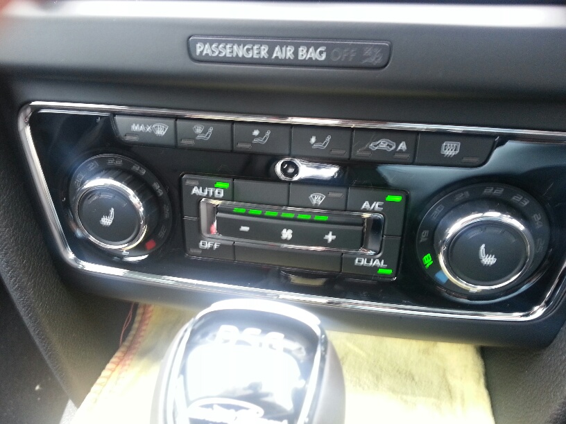

this is what the panel shows... but the fan is silent....
As yours is so new, you may find it's just a loose connector that wasn't pushed home fully at build. Should be easy for them to check this out as you have the fault code.
