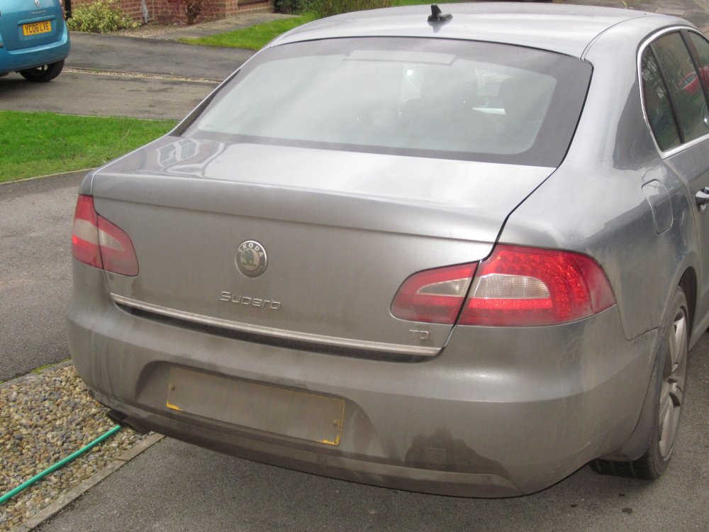

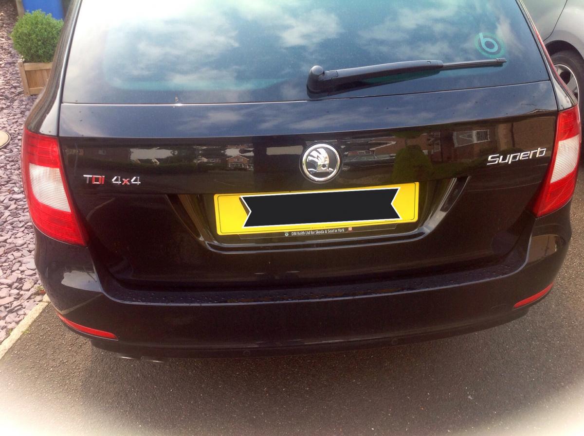

My original green badges were corroded so while the car was in having the tailgate realigned under warranty, these new badges were fitted under warranty too.

  • Haven't really read this thread in toooo much detail but judging by the fact that a dealer fitted this during warranty work, I would imagine that they have merely ordered current Skoda Superb badges,
  • Still like the classic old badges, but I think the new ones will have a longer life....

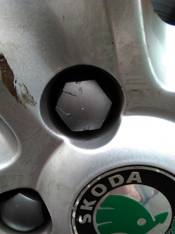

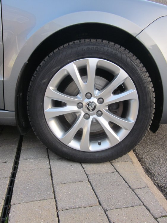

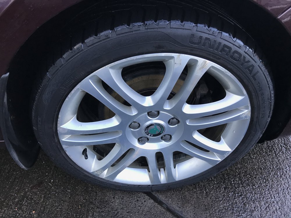

    Just a quick update, The screw in the centre and some pliers worked a treat, I braced myself for them being tight and I am not going to lie I ended up on me Bum on the first wheel, they all came off r
Why did the tailgate need realignment ?
I had an earlier thread, the corners had rubbed on the bumper and taken all the paint off.

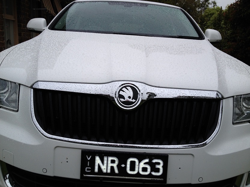

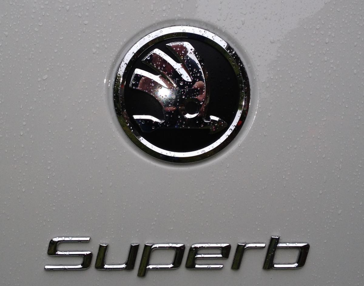

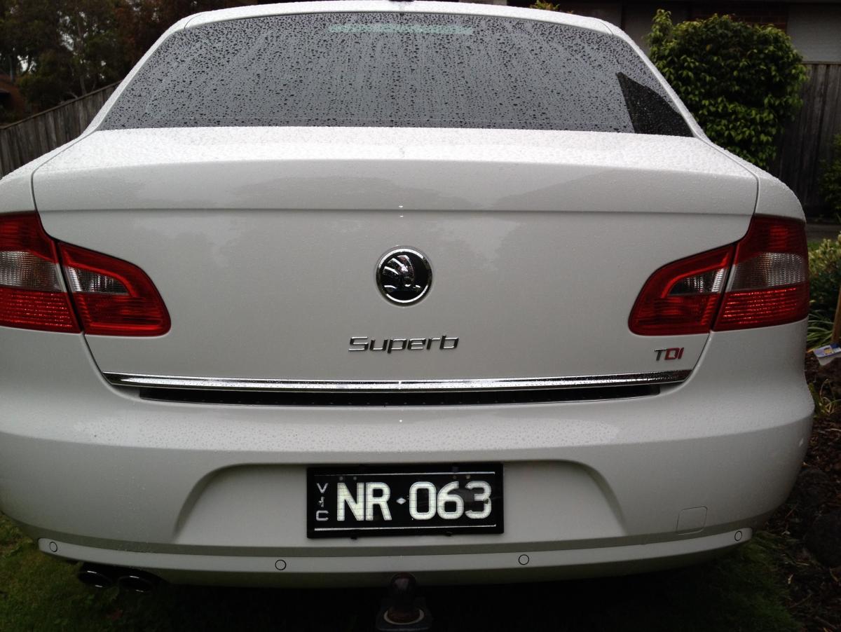

Hey Guys, This is my first post all the way from sunny Australia. I have also replaced the front and rear badges with the new style. There was a re-call on badges due to them fading or peeling. The outer lamination was lifting away. My dealer wanted to put the old style badge back on and it took a little while but I eventually replaced them with the new style. Makes the car look much newer and more fresh. I think the old badge is dated and I like the new style badge.

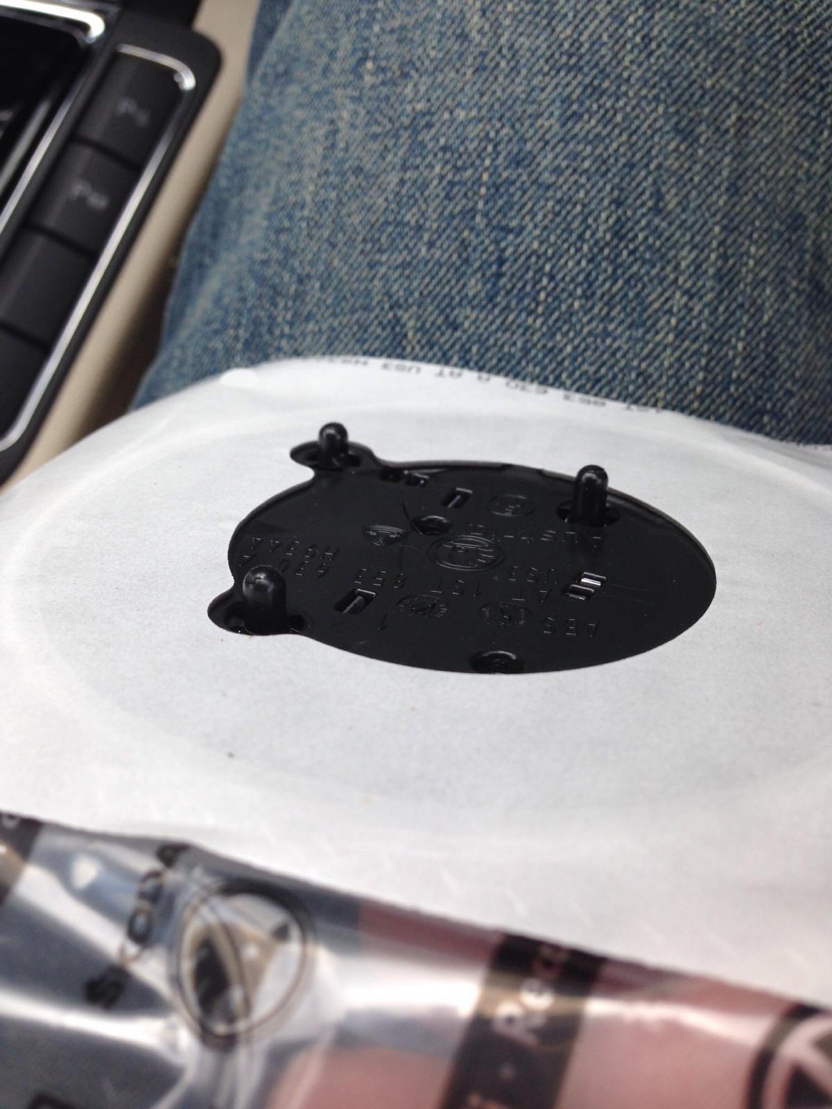

The new badges do have three little locating lugs on the back that need to be removed when fitting them to a Superb. Maybe they have left them on and that is why they aren't sitting flush?
You can see them in this pic of one of my badges taken before I took them off.

I have this problem too the front badge looks like it needed to be very slightly curved. The sides of the badge arnt fully stuck down but 4 months later its still on quite firmly. Its the sort of thing only i notice because i know about it. I did think id put it on slightly off centre or dun something wrong so at least i know im not alone.
:clap:  Those look awesome on the black car (jealous!).
Black badges with black number plates on a white car look very nice
Sent from my XT890 using Tapatalk
Laminated badges will always fade etc, it's par the course with them, even simple chromed plastic ones will pit and split eventually, all brands suffer this.
Yes, I've had the black and white plates for years. They do look a little more classy. I've also dark tinted the windows which makes the car stand out especially after a wash. It's one of the nicest cars I've owned. Fully loaded, Reverse Camera (Audi parts) mats, roller blinds ,KESSY, park assist, tow bar, boot moulds, mud flaps, Steering wheel paddles, 3 spoke steering wheel, Passat CC Mags, Sun Roof. It's a great car.
