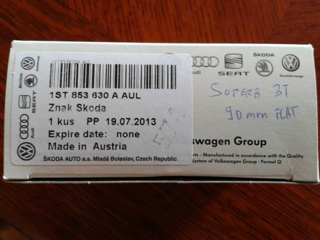

For Superb 3T MK2 you need 2x of this:
1ST 853 630 A AUL (90mm diameter, flat)
Fitted them to my SuperB hatch (MY2010) with no issues...
Those small black "pipes" that are behind, take them off (can not use them) by push by thumb/finger, and to center-position new badge use your good eyes...;)
Okay thanks for the part numbers. I have seen the above shown as the part number for the rear badge but I have also been told that part number 1ST 853 601 A AUL is for the front badge? Is this correct?
Or is it best to get two of the 1ST 853 630 A AUL badges as do they fit both front and rear?

Hey,
as I said, you need 2x
Same type of badge goes on front hood and back hood, flat type, not round or annything else!
