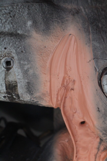

1 Under the rear wheel arches (behind the liners) where the rear axle hangers come together the underseal is failing here and if corrosion sets in this will be hard to repair.

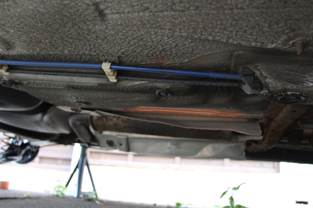

2.Under the exhaust heatshield where the centre section joins the floors, the underseal is peeling back here and will need attention.

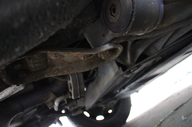

3. The floor strengthener in the above picture will also deteriorate, this was beyond saving.
Available from the dealer as 6Q08044121B £11.15. 8 nuts N01508315 £0.28 ea.
The exhaust heat shield is expensive so will need repairing.
