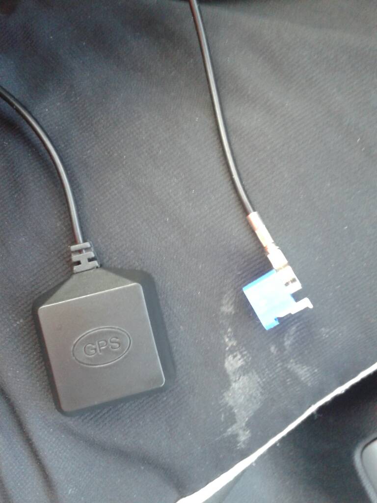

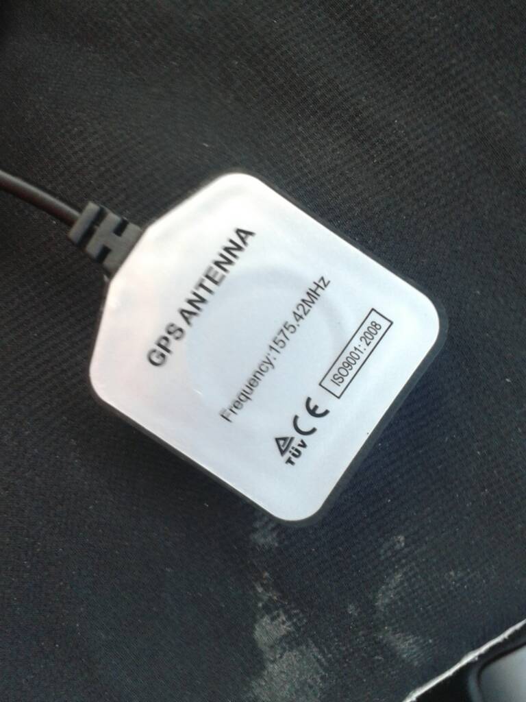

Additional for antenna...Stream uses a single lin in antenna and Collumbus uses a dual-line in antena, ans connectoes (plug) is not the same.
So if you want roof aerisl GPS antenna then you need extra new cable (dual-line), same story is with Bolera (like on SuperB 2).

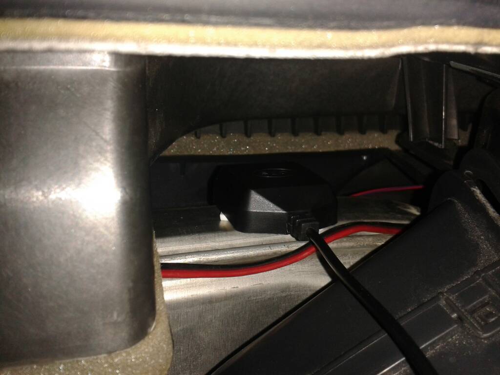

But if you want to keep existing roof antenna (FM) like it is and avoid pullung new lines, then is easier to buy a adapter for existing antenna lune that will plug into Columbus and for a GPS antenna to use small under-dash antenna that is fully working fine and is eady to mount and cheap for buy (cca.10 EUR).
This is adapter you need for existing antenna line (also very cheap):
http://pages.ebay.com/link/?nav=item.view&id=321051477744&alt=web
It comes with a GPS antenna to plug in so I assume u just put it under the dash somewhere hidden? And my fm aeriel will just plug straight in to the columbus?
No your FM antenna plug will not plug straight into Columbus...plug an jack are not same! Please read in detail my last post...;)
Your FM antenna will fit on the Columbus. Mine did.
As already said, you need to get it on the correct one of the double connector on the Columbus to get FM reception.
GPS antenna will plug straight in to the blue connector on the Columbus.

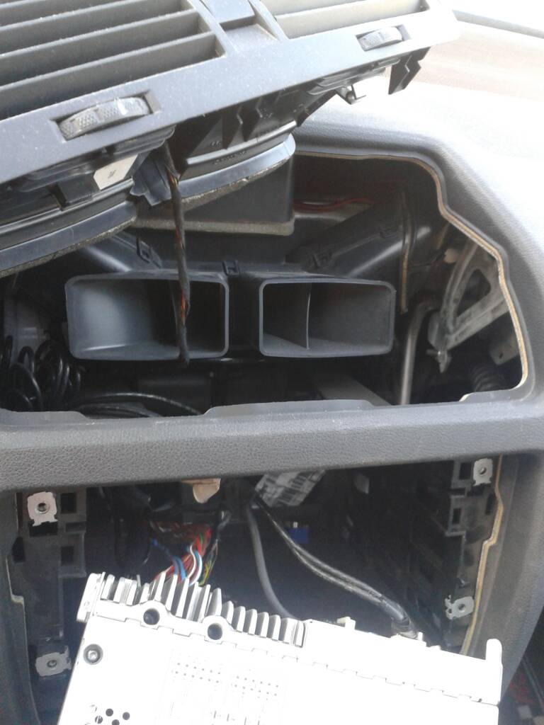

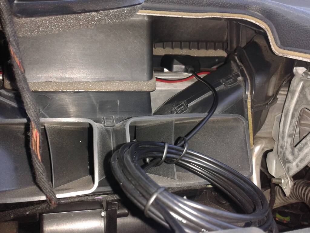

Underdash GPS antenna is easy to fit...my way;

You are welcome... that is how I did it on my vRS since I lost a satellite reception of satellites via Aerial antenna in one momment due to corosion (water), common issue.
But after a fix it is back ok now...

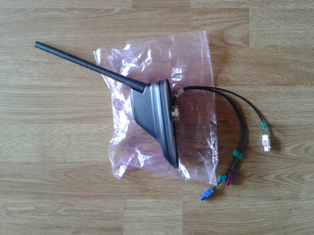

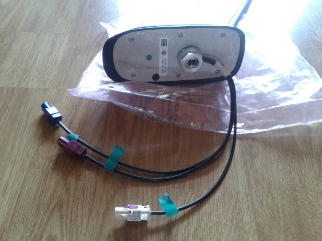

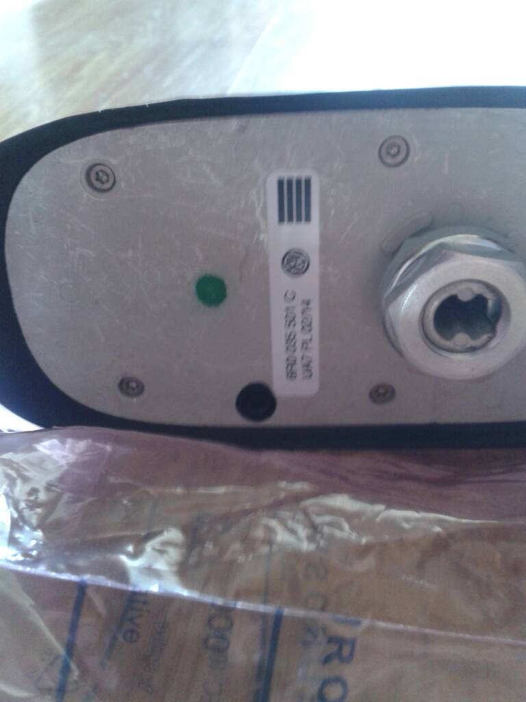

Bought recently new aerial (GPS, FM, GSM) for SuperB as well;
what was the part no of this fella ? And where u get it from
