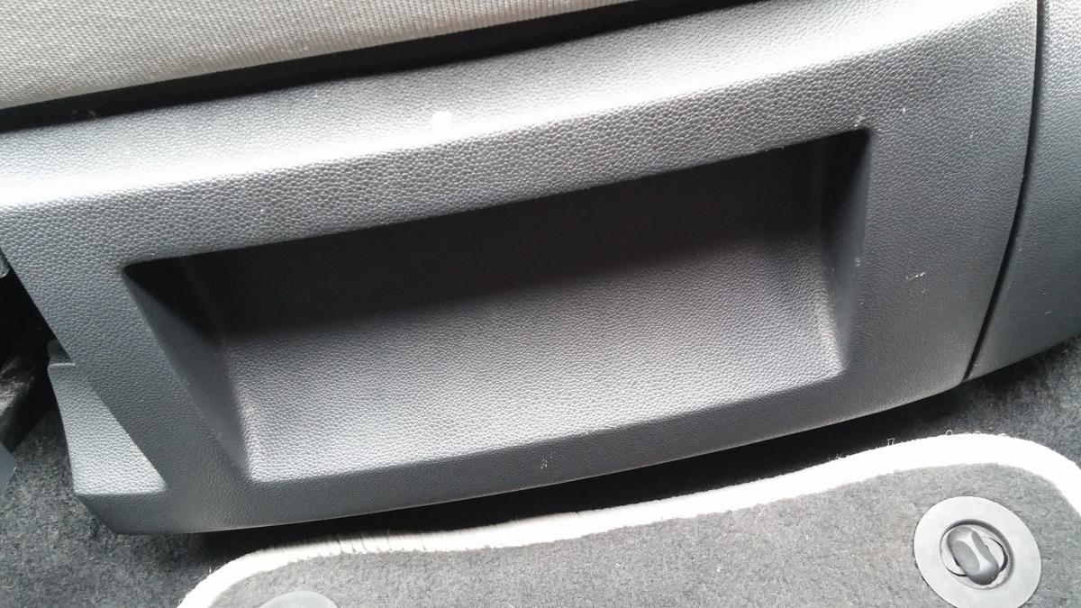

Post a picture of the seat base/box. :thumbup:
See attached image
It does look like a possible broken handle, as you said. :thumbup:
Any chance of a more head-on picture, just to be sure??
Yeah deffo broken handle, as above.
You might be able to see parts of the mech. Handle attach(ed) from the top, under the overhang, attaching to two hooked catches. If you can pull or push on the mech you might get it to open.
