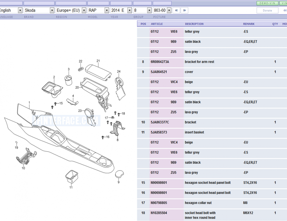

Anybody know if you can remove the centre arm rest and fit a blanking plate ? its a 14 plate spaceback se in red. cheers - Stuart
Should be able to remove the armrest, probably by removing the end caps (23 & 24) to expose the bolts and fill in the hole left in the console with item 11 (in the aproprate colour for your trim).
TP
