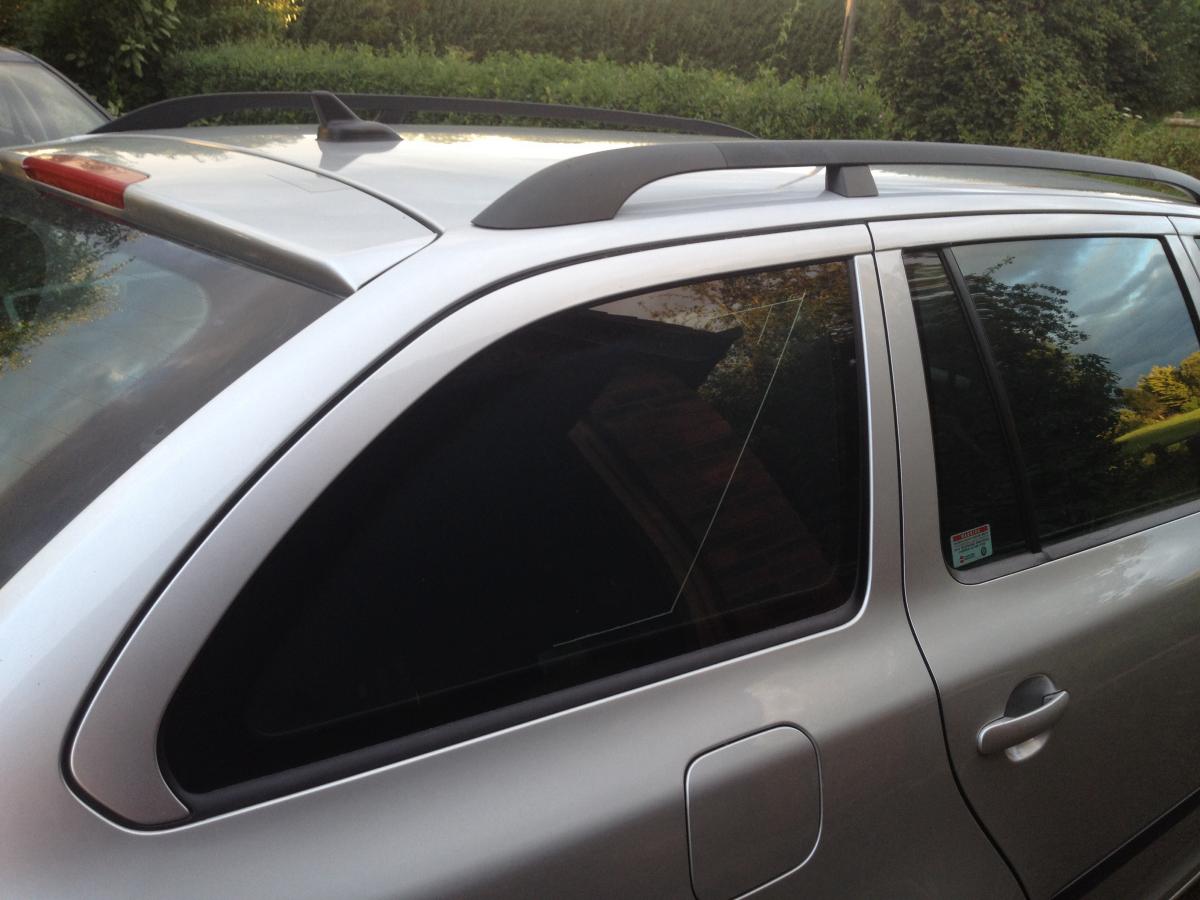

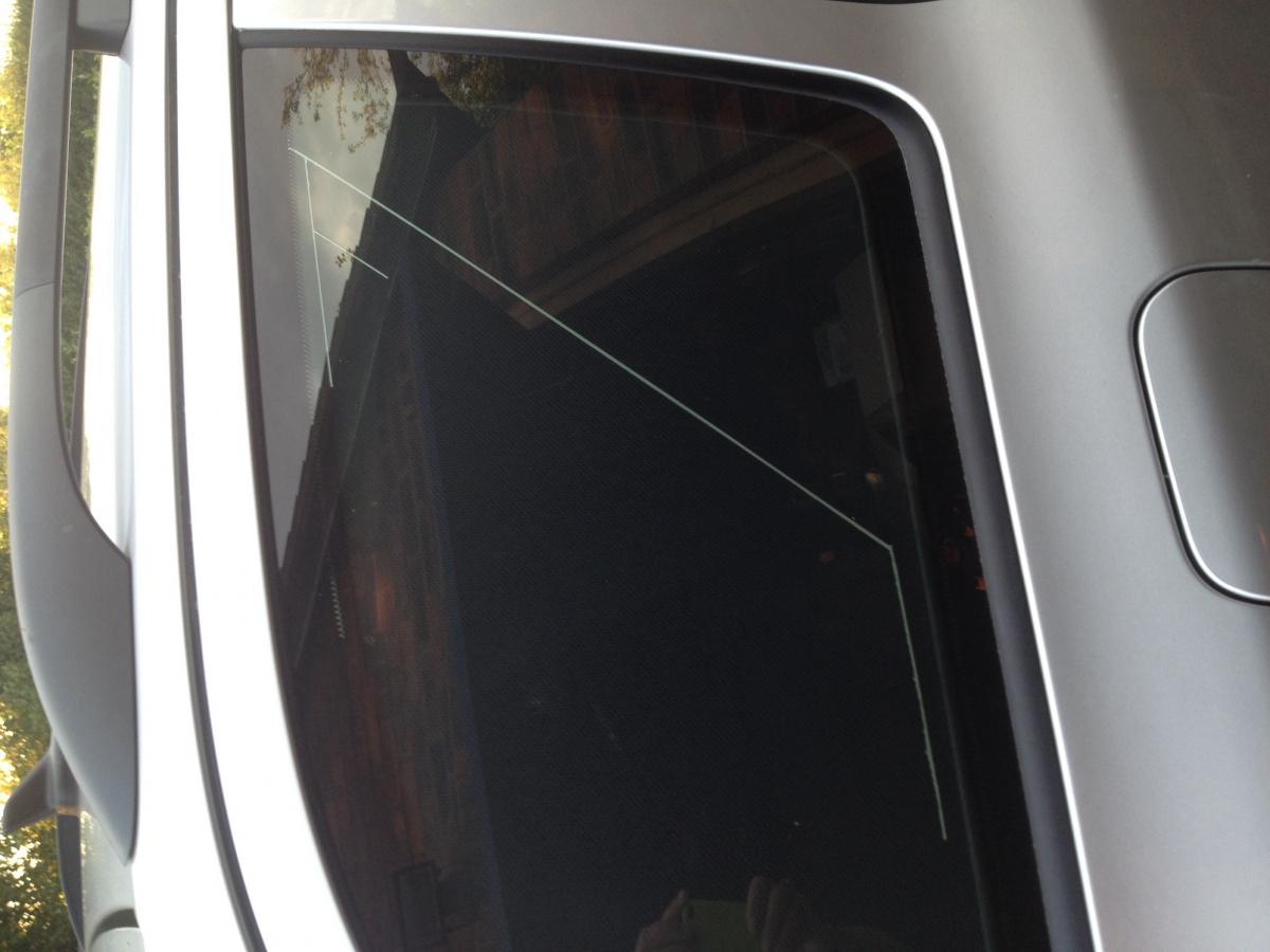

I've got a GPS & GSM shark fin on the roof (no radio reception) and have replicated the Octavia rear side window aerial pattern on both sides linked to a FM module on one side and AM/FM module in the other side taken from a Touran.
Apart from having broken a pin in the double FAKRA connector on the back of the Columbus, it all works fine.
Apart from having broken a pin in the double FAKRA connector on the back of the Columbus, it all works fine. would like to see that
Not as neat or as thin as I would like, but it works.
The roof antenna is GPS & GSM only. The OS side window is FM (antenna 2) and the NS is AM / FM (antenna 1).
Any questions feel free to ask. I don't know of anyone else who has done this.
^^^^ would be better if they did them in black ;)
Did 'them'?
It's not an off the shelf thing as I couldn't find any stick on FM antenna or any thing remotely useable.
The line is painted on by me using demister repair paint. I did contemplate the orange used in the demister, but couldn't find any.
As the car is silver, I do to think it looks too bad. If I take out the rear sun shades it's even less noticeable.
