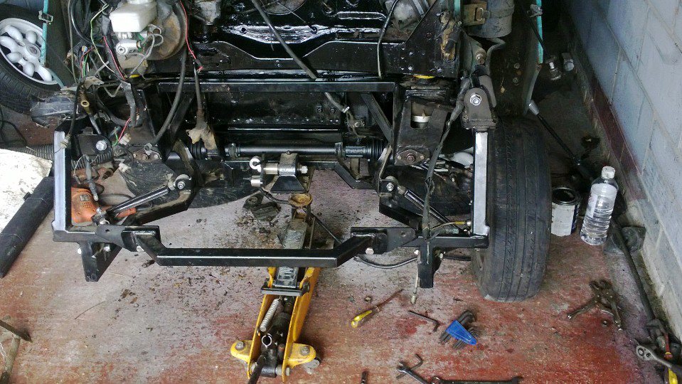

basically ride comfort means jack to me........ my usual car is a classic mini with the stiffness of a rock! it has a vtec up front and solid/poly bushes and mounts everywhere. And i happily drive that every day, until it rains or is cold. because then it is horrible.
cheers for the info bud
Sounds brilliant! You have to provide pics now ;)
its not a good looking car lol who cares what it looks like when it will find a gravel trap at some point lol
i'm afraid these are the only pics i could gather quickly while at work
Cool! Love minis!
