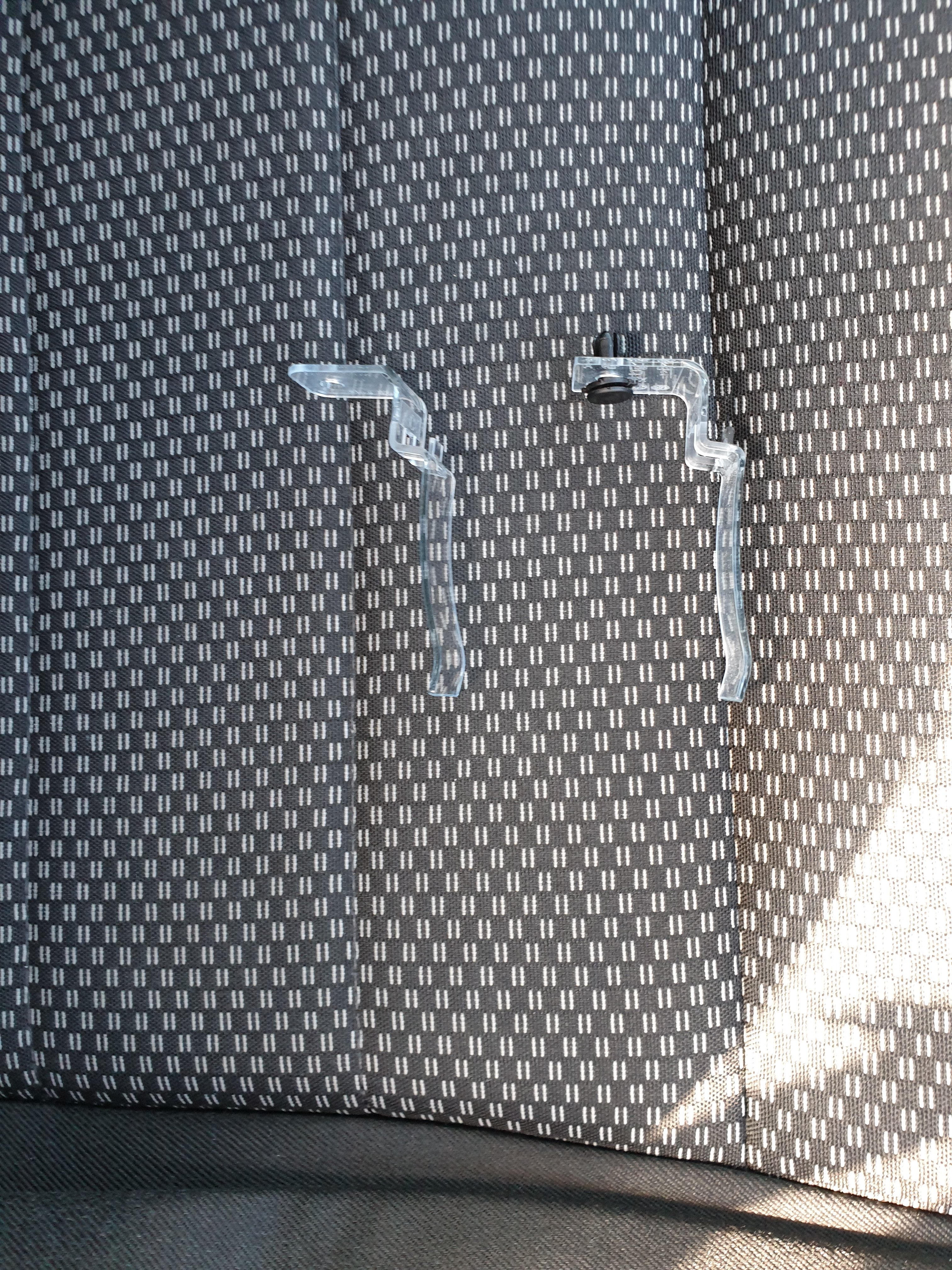

For anyone that requires the part number from the dealer for a replacement ticket clip, here is what I picked up.

This is the old clip (right, with the push rivet still attached) and the new one (left).  They are identical apart from the new one has some rounded corners.
Total cost including VAT was £0.64.
Hope this helps.
