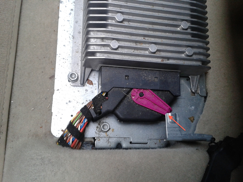

On the side of my Amp under the passenger seat the connector has a purple bit - how do I undo the connector?
Does anyone out there know how to undo the connector?
Post a photo of the clip if you can VAG uses a few clips that are easy to remove when you know the knack.
OK here it is:
Slide the pink leaver clockwise, this should unlock the plug, it should then just pull out.
You may need to press a small black tab in to enable the pink leaver to move
Where is the tab likely to be?
If there is a tab then it is going to be on the lowest edge of the leaver (under the silver tab)
