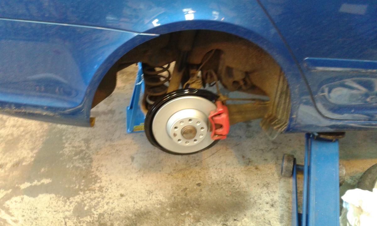

I did this job today,all ok & nice & shiny(for now!)  :D
