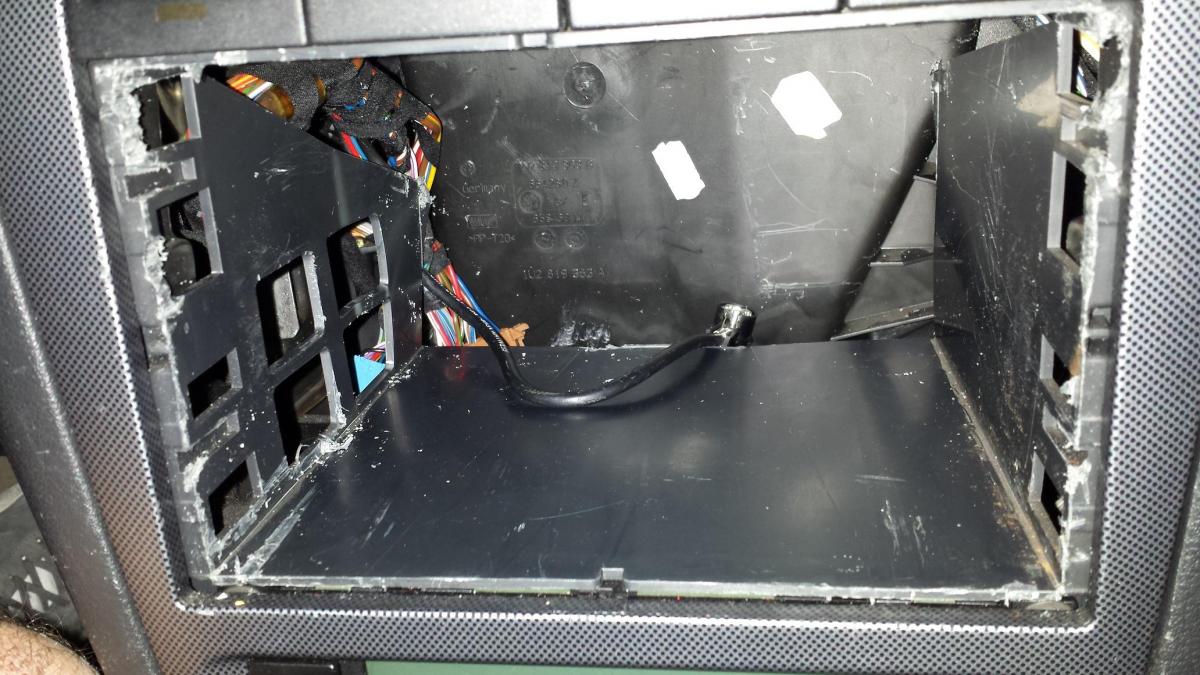

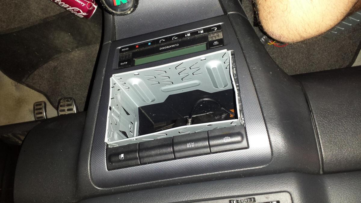

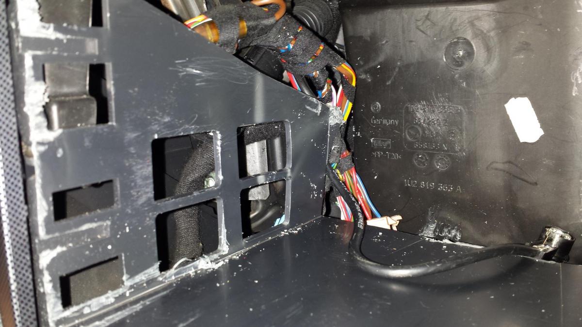

attached some pics to show problem im having.
I just fitted my double din today with a cage that looks identical to yours, my cage kept catching the last square cutout hole to the left as I tried to slot it in, I found by pressing the plastic away from the cage when I was sliding it in gave just enough clearance for the cage to slide fully home, hope this helps mate
so i dont need to cut anything else away or buy anything else? tried properly hard to make it fit but wont budge once it gets to a certain point.
No it should fit, although it is a very tight fit, I didn't even need to cut the h bar
Brute force and ignorance is needed
