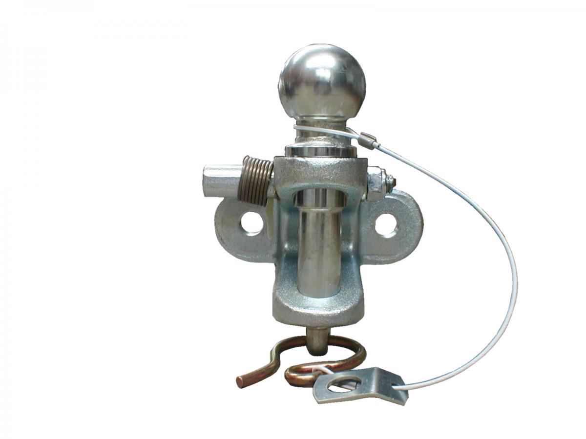

Possibly showing my ignorance here, but what would you use the pin type ball you show for?

Some farm trailers but I don't know much else
Farm and construction trailers mainly. Generally heavier things than you'll be able to tow with the Octavia anyway (legally anyway...), though tow-able construction site generators tend to have them and maybe those traffic light control generator units.
They can be useful for attaching tow ropes, as you tow from the centre of the car, rather than offset to one side.

The pin ones don't seem to be worth considering.

Forget the "pin and ball" for your use.
