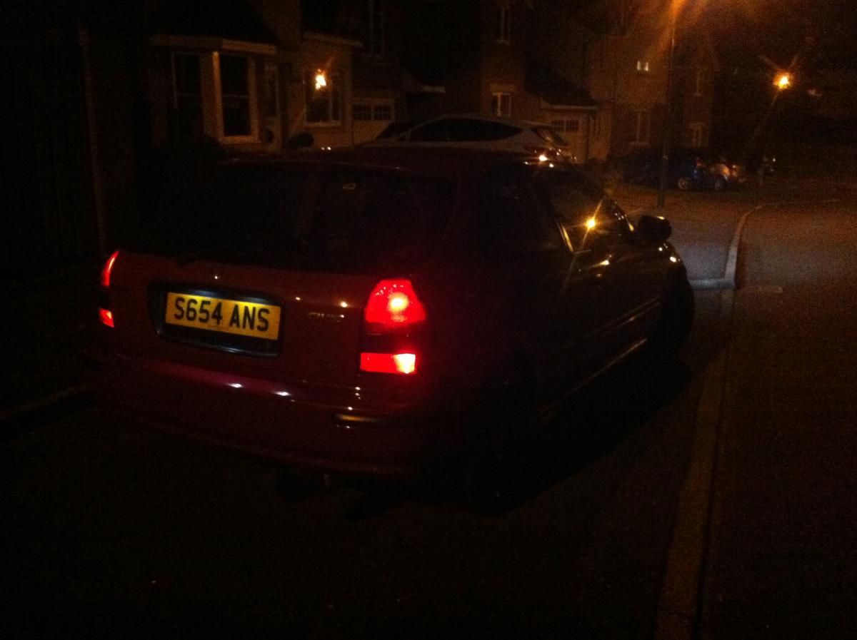

Hi there just an idea I had but when I see older octavias I noticed when the tailights are on it lights up the top, bottom and sides which look pretty cool where as on the fabias its just the bottom so it made me wonder if you could swap the bulb holders for it to work or modify the wiring? So the tailights look like this: http://img707.imageshack.us/img707/4484/skoda13.jpg on the Fabia! I done it to my old civic where i re-wired them i'll attach the photo. CheeRS!

Yeah i always liked that with tailights, it was an easy mod on my civic and definetly made it look better at night
