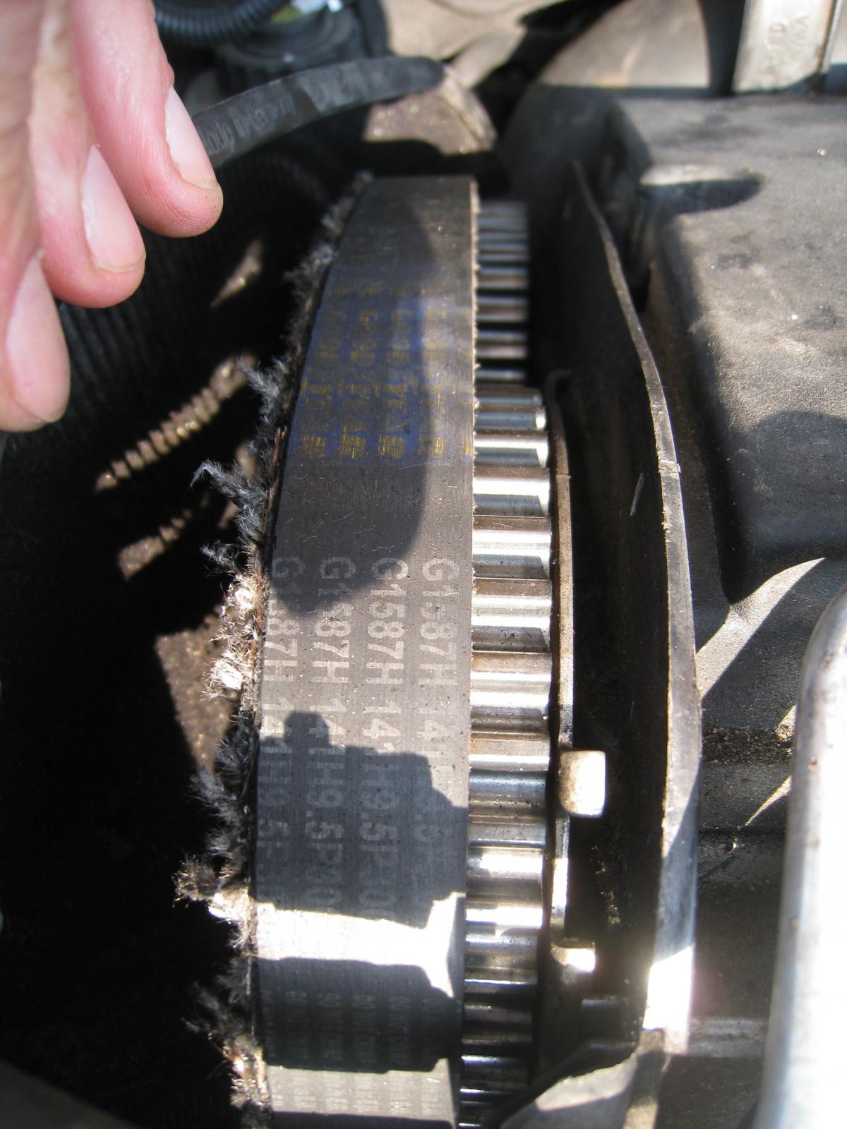

We had a similar failure on a Passat with the same engine, the belt went slack just like the one in the photo after 30 miles.  The fault turned out to be a sheared tensioner retaining stud.  Luckily for us, we had used genuine parts from our local TPS including the 60 pence stud that failed.  Our customer got a brand new engine in his 100,000 Passat courtesy of VW parts warranty.

Thank you all for your hugely helpful responses.  The car is now with the garage after a 12+ hour recovery from Scotland courtesy of the AA.  The garage owner totally accepts responsibility and will repair the car.  The fault sounds virtually identical to "fordfan"'s above; a sheared bolt.  I didn't have my camera this morning and the bolt is hard to see from the outside, but attaches the part immediately below the 2 toothed belt sprockets in the diagram (tensioning pulley?).  This was hanging off so the whole belt had gone loose.  Investigation this week will determine whether the engine has to be repaired or replaced.  First and only timing belt failure for him in a 15-year career.
That's the tensioner and the tensioner stud is what it is mounted on.
