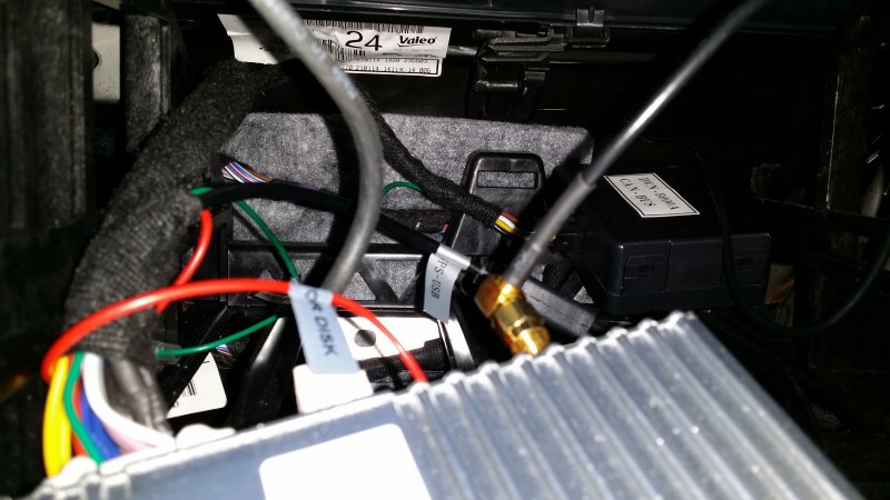

In Denmark you can buy a third party windows CE navigation solution that is plugged into the bolero in a similar fashion. Usually placed behind the touchscreen. The manufacturer is Dynavin but could also be a zenec unit. Long pressing one of the Bolero buttons takes you to the nav...which is horrible and could well explain what you have experienced.
I should mention that the solution is sanctioned by Skoda Denmark and isn't invalidating the manufacturer guarantee of the unit.

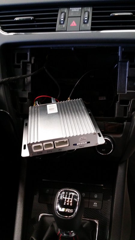

Well, Trekster called it... Photos (attached) show a couple of boxes. Two minutes on Google gave me the Dynavin user manual (although the Italian version).  Scan through that for a minute and I now have sat-nav on my Bolero. The map and interface graphics are a bit shonky and I have no idea how well it works (although it loads far faster than the stock system in the last car I had), but I'm actually very happy!  I thought there was no way of getting sat-nav into the Bolero and had given up on it and was using my phone instead.
Now to have a word with Skoda UK and find out if it has actually invalidated the warranty or not...
I also want to find out if there's an English manual available and if it's possible to update the maps on it.  And I'd love to know how it ended up in my car!

Its about 300£ but..i must admit that the response in Denmark hasn't been stellar. The system is dated and as I've said runs windows CE..which by nature is crap..
But I guess its better then nothing, however it is MILES behind the original Amundsen and particularly Columbus.
It supports English and the maps are updatable.
I'm trying to track down more info on it.  Found out the maps are done by Desnav.com and should be upgradable - I'm emailing them to find out if it is without buying a new license.
The system also includes a media player and will play music, movies, picture slideshows and even eBooks from a memory stick.  Not much use when the slot is buried behind the dashboard, but I think it might be extendable out to the cabin.
Watching the video on that page, that's exactly the same as in my car - hold down the Media button to launch the thing.  The menu is exactly the same too, except as mentioned it uses a different navigation program, which is pretty nasty looking.
