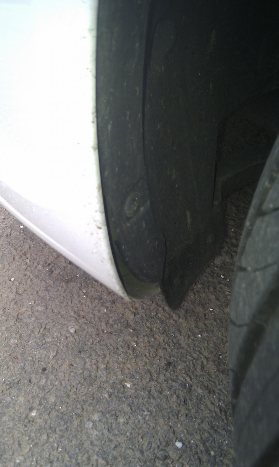

Another thing was another gap on the inner wheel arch, as per the pic attached. Again, is this normal?

Any thoughts as to the gap in the pic or if the gap in the boot is 'normal'?
NickP on here rejected a brand new car due to either excessive or uneven gaps so this may be made by the same person - Friday Fred?
