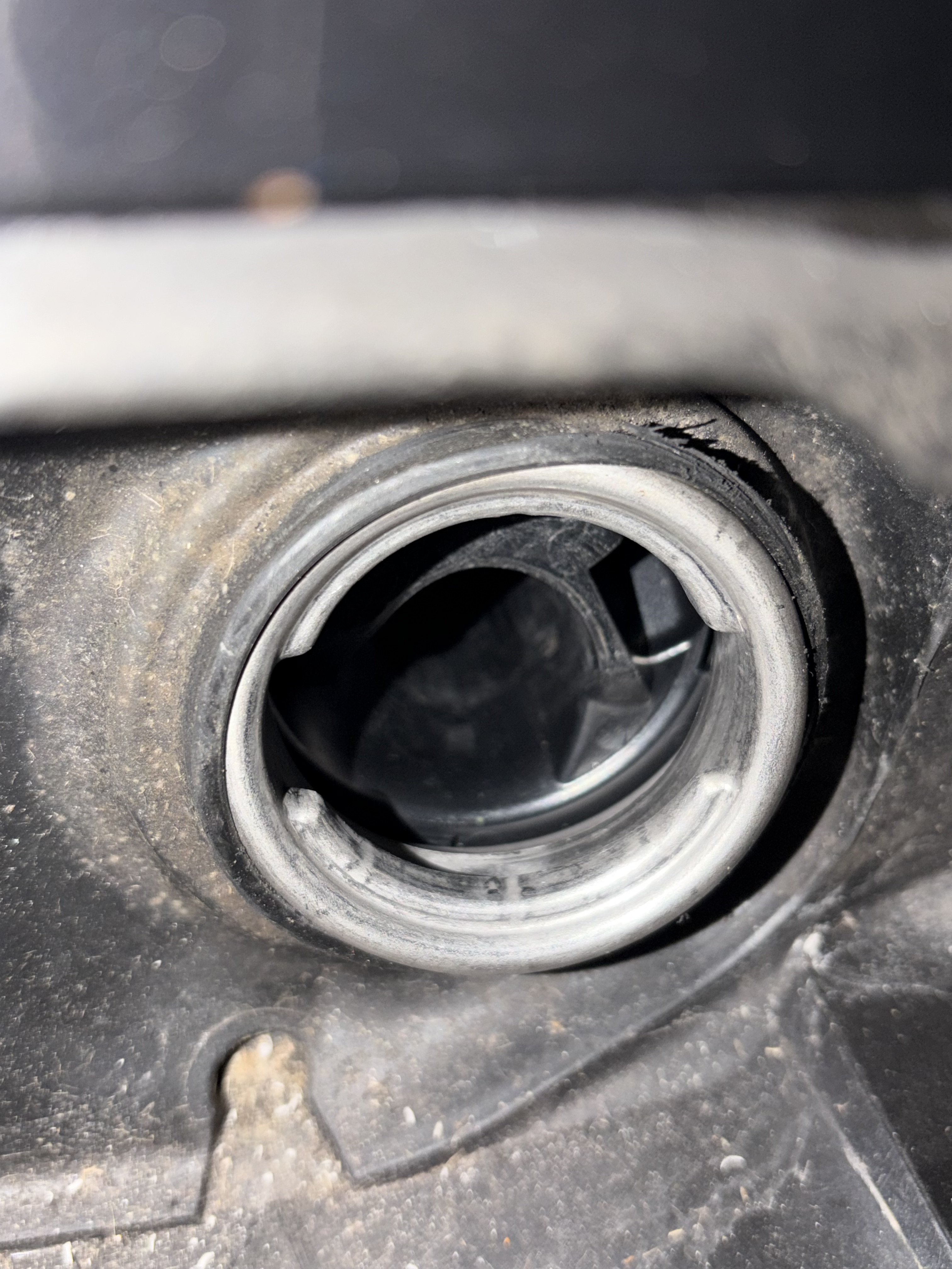

Just managed to have a look at this and, although I'm now covered in black crap, have confirmed  it's the same pipe that has gone again -small split at the back near the turbo...   so given the cost to replace last time was stupid and the part is only about £40 I'll probably have a go myself

Well I finally got the part and fixed it this morning.
Doable from above provided you remove the Flexi pipe from the MAF to the egr and have small hands.  Still a bit of a bugger though as the clip for the turbo end needs to be removed from underneath and your effectively working blind.
For those doing it themselves I'd recommend putting the turbo end on first and putting the clip on the boost pipe and the levering it onto the connector as opposed to trying to fit the clip into the groove in the connector.  Once that's on a bit of oil on the hard pipe and inside the boost pipe makes it easier to push on and get positioned before fitting the band clamp to hold it all in place
