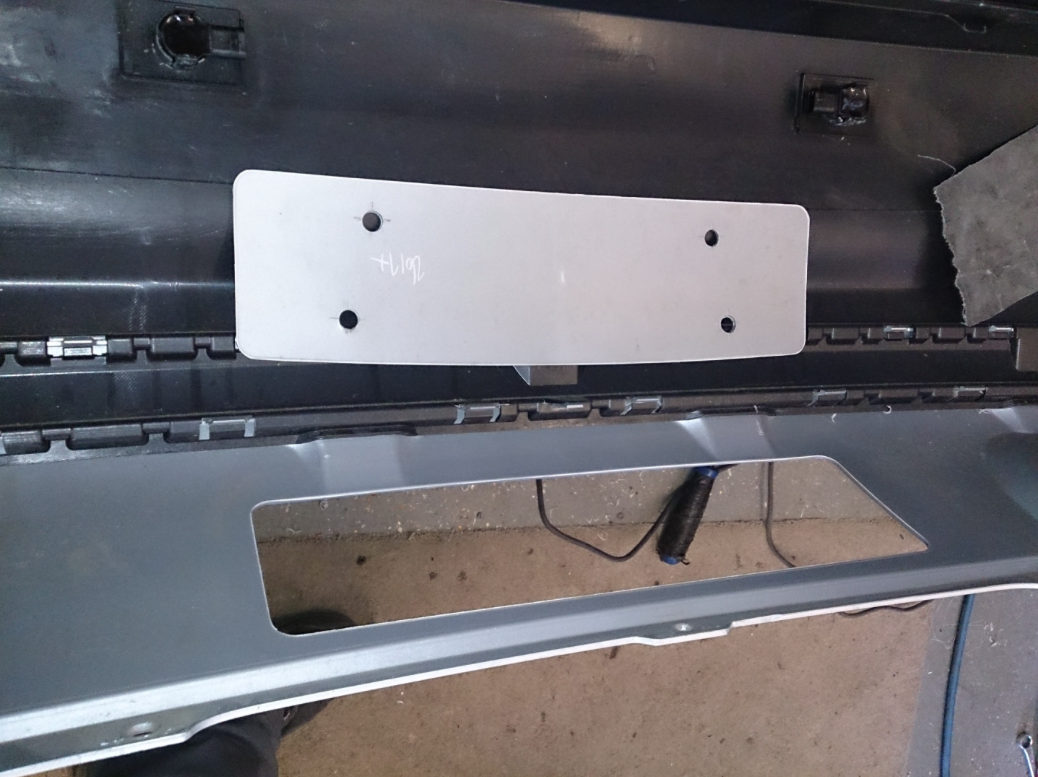

I am curious as to why they carefully marked and drilled four holes in the section they were to cut out!
Not sure, I was in the office when they were doing it, probably on my second cup of tea! Might have been something to do with using the genuine Skoda cutting tool needing accurate placing.
My fitter used a Stanley knife. Sharp blade....accurate cut. Cover fits perfectly

The official kit comes with a frame that fits and is glued inside the bumper, around the markings that you have carefully cut. This then forms the "hatch".
I've not seen a template and as said it isn't needed as the markings are quite obvious inside the bumper.
Welcome to measure my cut out if any use, assuming facelift is identical! ;)
