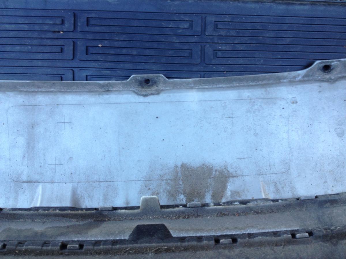

Are markings for tow bar cut out on the diffuser?

Definitive answer - yes, the markings are there.
I guess that the four cross hairs are for pilot holes to be drilled so that the stamping tool can be correctly aligned. But I don't think my dealer did use the tool.... See this post.

How is the lower bumper removed to make the cut-out ?
If you mean the silver bit, there are push-in clips around the edge and a couple of bolt/screws at the back.
