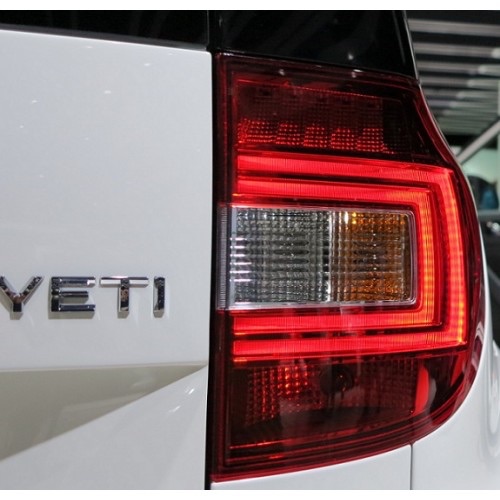

I'm looking at fitting the rear LED's on the Yeti, if I get the CANBUS issues then resistors will be needed, I've done some looking into using a heat wrap (such as used on exhausts) on the resistors to protect other wiring and plastics as they can get rather hot.
Does anyone see any issues with doing it this if I'm not able to seat them anywhere?

I presume you are fitting a set of the new LED style Yeti rear lights?
Do you realise that it is only the rear (and possibly the brake lights) are LED's, and not the others?

It is yes, I'd just assumed they were the same as had seen fitted to the elegance, but didn't know it wasn't all the lights in the unit.
Thanks for the heads up Graham, I'll have a look for the thread you mentioned and pop into the dealers as they've got an L&K I can use to check.
