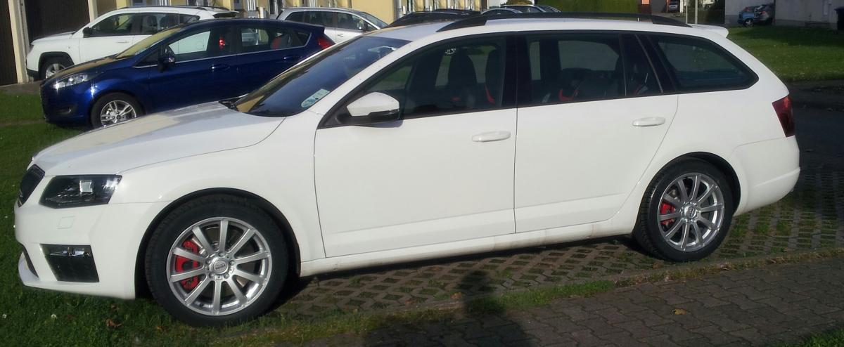

Just fitted my winter wheels n tyres today.
A painful €750 for the set but happy with the result.
What do you all think?
Alloys: MAM W3
Tyres: Conti winter contact T850 -- 225/45/R17 91H.
I think she suits the VRS just fine.
Blahde2 is that in BFG?
I like them currently looking myself for a set for winter. Is 225/45/17 the recommended size?

Very nice the wheel sit will on the car

Yes, you will need 17" alloys and this is the not only the recommend tyre size but also the cheaper of the two that fit.
If you don't have a VRS then 16" or even 15" steelies shold fit and will cost quite a bit less.

Make sure you use a good sealant on the MAM alloys. The paint / lacquer on my set of 16" MAM rims (similar design to yours) is looking pretty shabby around the centre cap and between the joins of the spoke and the rim - only 2 seasons use albeit one very harsh winter and several trips to the Alps where they would be encrusted with 5mm of salt after 700km of driving - car washed weekly or more too. Also not too sure what the rims were protected with during manufacture but they are forever losing balance weights as they just don't seem to stay adhered to the surface.
