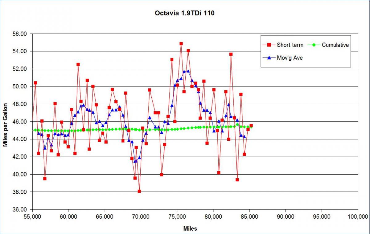

I have kept a record on a brim to brim basis for the last 30,000 miles. The average is 45.4 mpg, with short term averages (still several tank fills) between 42 and 52 mpg. There is big difference between summer and winter and between short journeys and longer journeys - best is long fast A roads.

One tankful is not enough to get a long term average fuel consumption, as shown in the graph in post #6 which shows huge variability between refills even though it is brim to brim every time. I put this down different miles left in the tank and different cut off points on pumps.
I believe the "50 miles left" warning is calculated from the rate of fuel consumption just before the warning, so is inconsistent. And of course the miles will depend on the type of driving in that one tankful.
