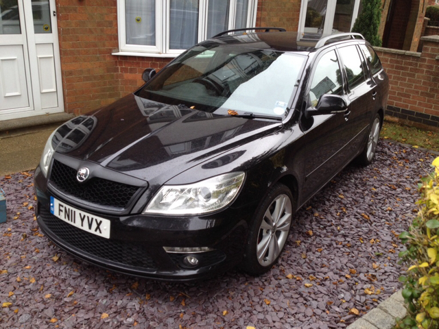

Hello everyone. I have a 2012 octy VRS and have bought the Octavia II 09-12 Facelift - racing badgeless grille in RS Honeycomb design - KI-R from Superskoda. Just about to start fitting and realised about the bonnet release mechanism. Has anyone fitted one of these grilles to their car and can you still open the bonnet? It says so on their website but I really can't see how?! The handle ends up sticking out of the grille on my oem grill when opening.
I hope someone knows and can help as have just paid to have it painted and hope it doesn't need modifying. If anyone has any info or guidance that would be greatly appreciated.
Cheers in advance! Rich

Just bend it dude. Fitted one to my brothers car and it works fine.post-114255-14149337346288_thumb.jpg

You cut it down in size. Milotec say this on there website. Did it on my MK2 and worked perfectly [emoji106]
I just bent mine and it works fine.

I've just fiited mine yesturday and I had to cut a slot to fit it but it's up to you everyone has there own way of doing things
Here's mine not the best picture but if you zoom in you can see the slot image.jpg

On the instructions it shows cutting the end off just at the curve. Or you could do as above and bend it.
