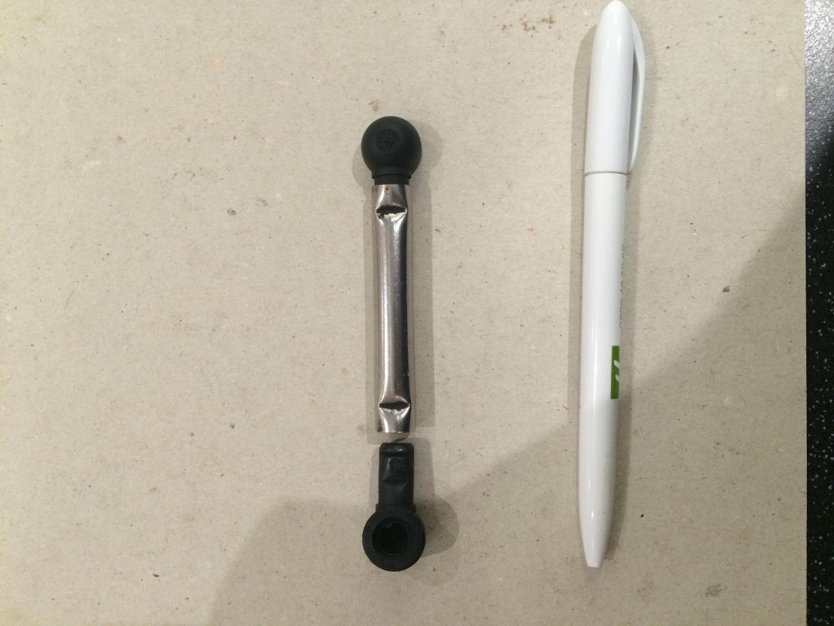

Turns out front sensor is the issue for the headlights-post-119919-0-12222600-1415553318_thumb.jpg
When I had the springs changed the mechanic obviosuly didn't disconnect the sensor and just dropped the suspension. The silver arm links the sensor arm to the chassis and the rubber from one end has now come out and won't go back in as they are crimped! Grrr.

Any idea how to get the rubber bit back in or a part Number of not?
Take it back and get the mechanic to do it properly
In my case the rubber actually broke off the silver arm too, and I reckon it was the people who fixed my car after a recent bump that broke it. Luckily I managed to use epoxy resin to fix it.

Looking at the crimped end,surely you can gently move it sufficiently out so you can crimp the plastic back on.
