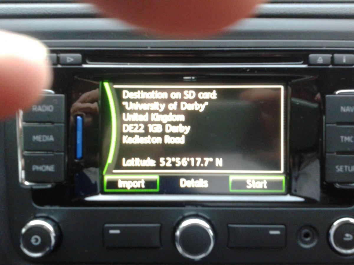

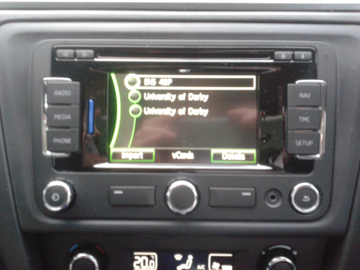

Thank you Mort.
I have copied both Derby Uni cards as above into Notepad then saved them as Derby Uni.vcf for top card and Long Derby Uni.vcf for the lower card which includes the X-NAVADDR entry. then copied the vcards to 'destinations' on the SD card.
Amundsen+ loaded both versions and showed the names not postcode on screen as below and apologies for rubbish mobile phone pics. Don't think it could focus that close but should show enough.
When navigation started the message was 'Destination is not on a digitized road'
A great improvement but somehow the destination is wrong.
Again thanks for your help, it was/is driving me up the wall!

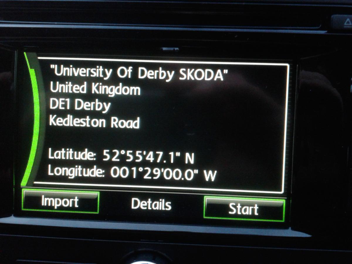

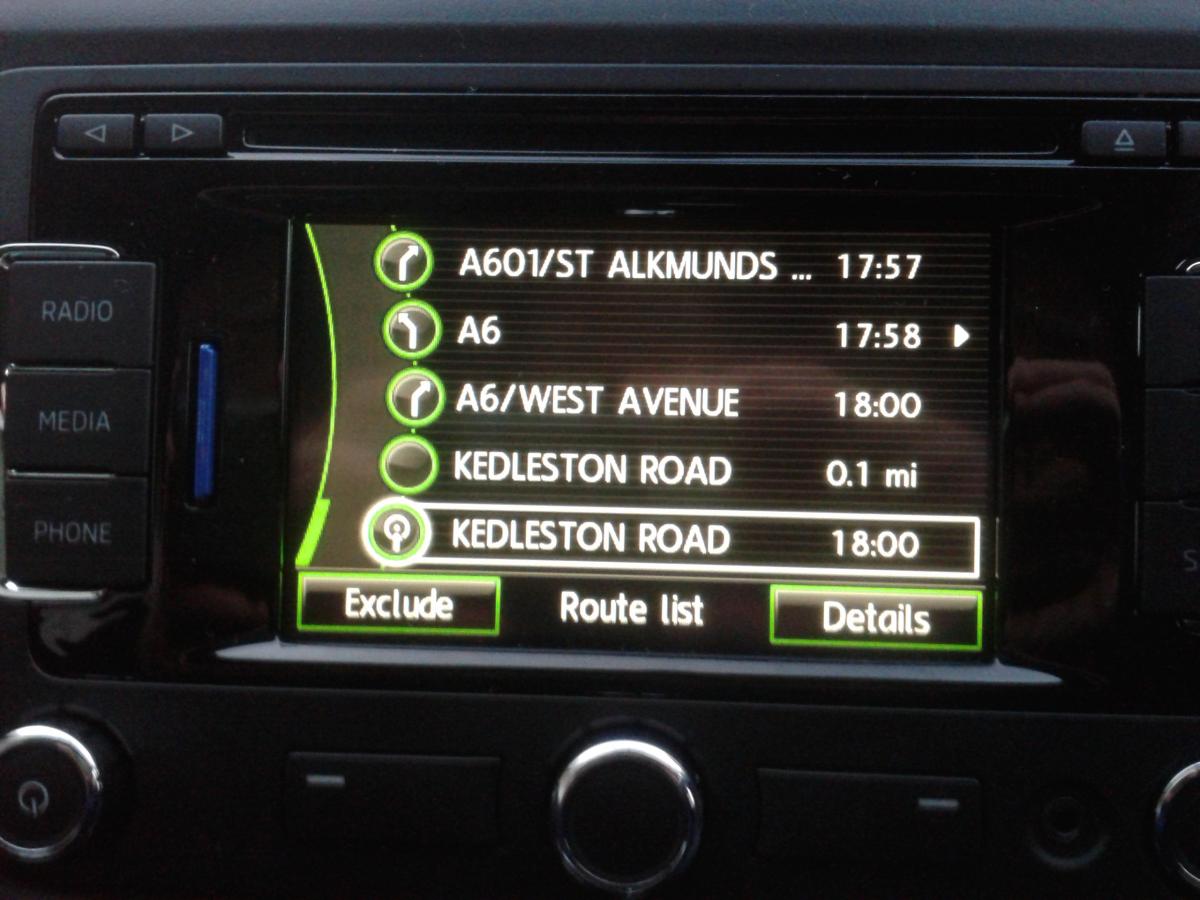

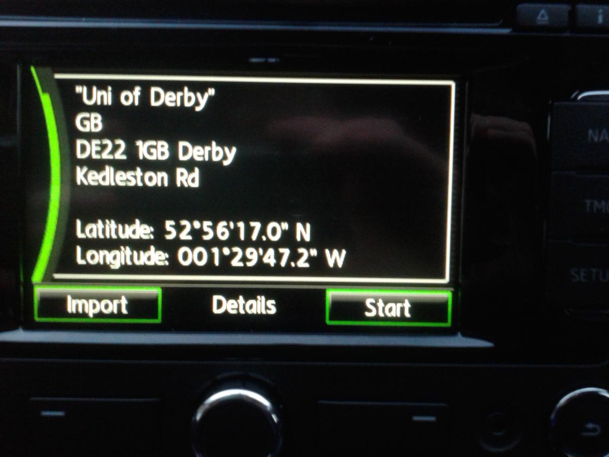

Hi Mort.
Sorry I've not got back sooner, been one of those days!
The one I wanted to work, did not.
The one you thought might actually work - DID
As you will see the route ended where it was intended. :clap:
