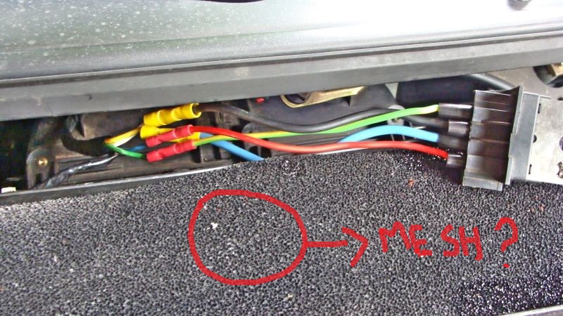

There you go. The connector with rust is a common problem. Water seeps in, pins oxidize, the high contact resistance and high current produce heat that melts the wires and connector together. Worst case you'll need new male connector and new block of resistors.
Repair photos below. But use the same wire colours and keep track which goes where.

By the way, what kind of mesh have you in the air intake? It's for the excessive rain?
That is a photo from the Internet, my wires & conectors are like new (good maintenance). There are many other forums dedicated to Skoda Felicia with many photos. I have posted them below.
The best protection against rain is no protection and bottom plug of blower housing removed.
