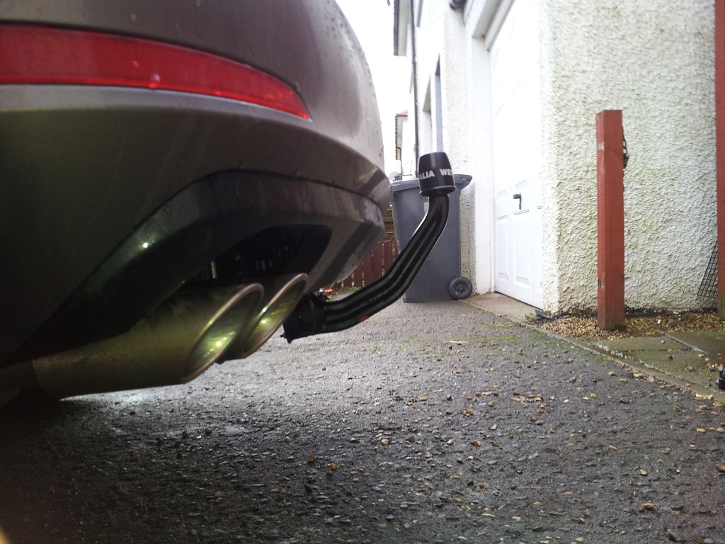

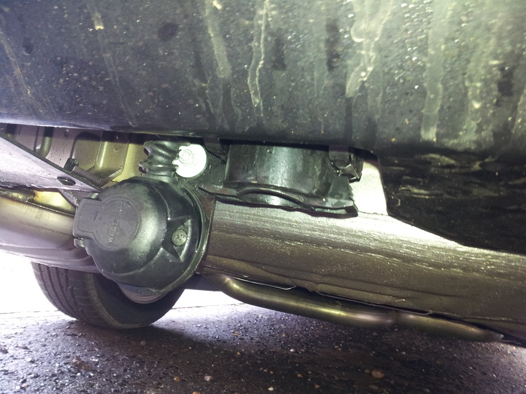

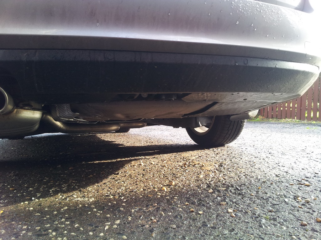

Had mine fitted by dealer, but this is bumper cut they did if that helps.
post-109690-0-28927100-1417383575_thumb.jpgpost-109690-0-77326000-1417383606_thumb.jpgpost-109690-0-75444500-1417383625_thumb.jpg
Thanks All, I did pay for the preparation which is for the electrical prep so shouldn't be too bad. Glad to see the cut out isn't too big. Good advice and photos.
