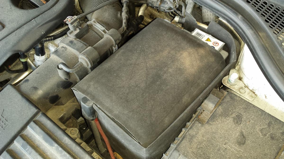

Finally got round to fitting the Bosch S5 096 battery today.
It's about an inch longer than the original battery, but the tray is plenty long enough to accommodate, as others have said.
The little battery coat doesn't quite fit round though, had to leave a little gap at the rear, but done in such away the flap at the top still folds over nicely.

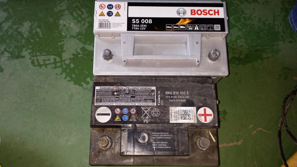

Some photos in case it helps anyone else...
OE vs. new...
You can see the length difference (and the difference in ratings):

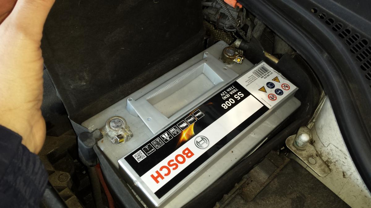

The battery "coat" fitted round the new, larger battery:
And the battery in situ:
