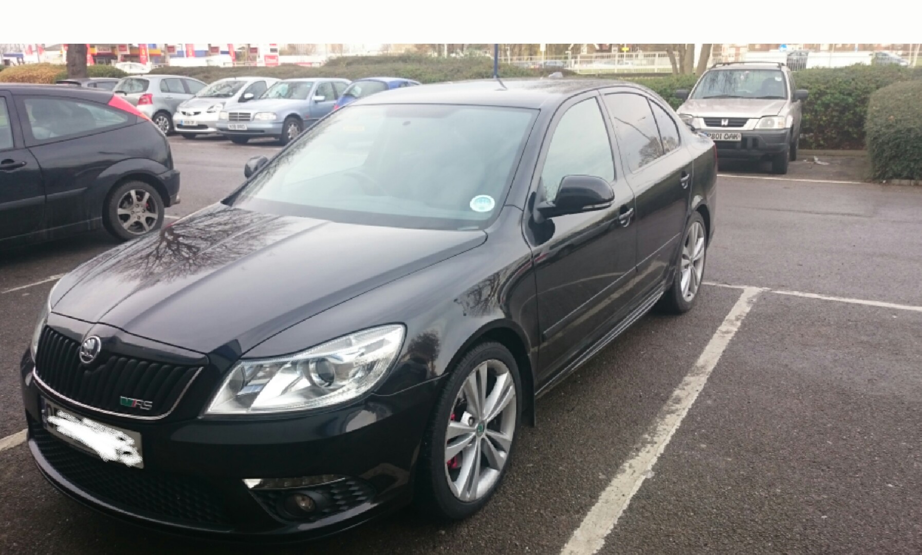

I vouch for pi springs too. They might be cheap but im totally happy with mine. Thought you had took yours off radders?20140523_182817.jpg
No that was ChrisRS.
I took my Pi springs off due to the Dampers being shot
Replaced the whole lot with a Bilstein B12 kit, but the drop is only around 15mm compared to 30mm with the Pi springs
