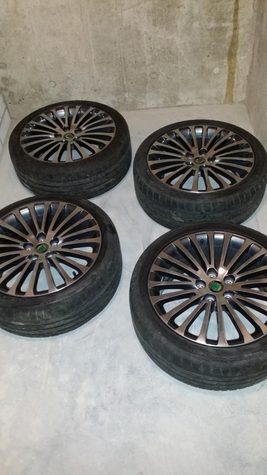

Could not resist and bought these:
Got them polished and prepared for the summer.
Now I need to get new tires, as those, that are on the wheels are already tired.
I know that the standard size for superb is 225 40 R18, but i do not want to loose comfort and pot hole resistance compared to R17.
Did a little investigation and found out that:
*Dealer says that this difference in diameter will not have any impact to handling, ESP or ABS.
*Insurance says that they do not mind the different tire size.
*The speedometer will show exact speed, because at the moment it is calibrated to show 5 km/h less.
So the only thing that puts me back is that the 225/45 are about 50 eur for one tire dearer than 225/40 (goodyear efficientgrip performance)
I would like to know if anyone has fitted the 225/40 R18 and do you feel any difference from standard tire?

I would stick with 225/40/18
If you go up to 45 the tyre will be too big and throw your speedo out

For the GY EGP they are £89 for 40, £123 for 45-profile. GY F1 are £93 for 40 and £115 for 45.
Nice alloys by the way!
I'm having the same thought as you - going to 225/45/18, instead of the regular 225/40/18.
I want to upgrade from 17'' 225/45 to 18'', but the 225/40 is a very narrow section, so I would like to go for 225/45.
What have you decided/ bought ?
Later edit: just went to a tire compare tool.
It seems that 225/45/18 is way different than 225/40/18, it's a 1cm difference in side-wall height, so it has a big impact

I am toying with the idea of getting 225/45R18 too, but the tight gap between the tyre and wheel arch (fender) do not give me the confident to go ahead withe the change. Checked online a couple of months back, the "largest" tyre that can be fitted to Mk II Superb is 235/40R18. In a layman term, these are the differences in overall diameter of the 3 size:
225/40R18 => 637mm
225/45R18 => 659mm (+22mm or /11mm in height)
235/40R18 => 645mm (+8mm / +4mm in height)
