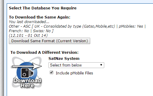

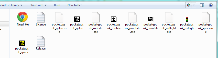

For information I downloaded the safety cameras from PGPSW and unzipped the file. The download I chose was " Other - ASC [ UK - Consolidated by type (Gatso,Mobile,etc) | pMobiles: Yes "  I chose this download to get the ASC format as opposed to the TomTom OV2 format used in the past.

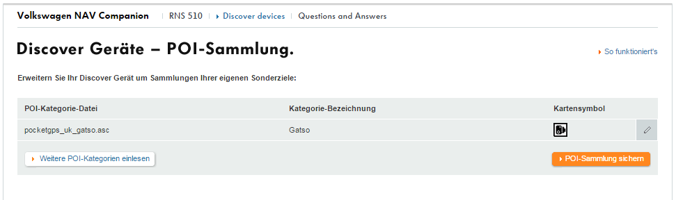

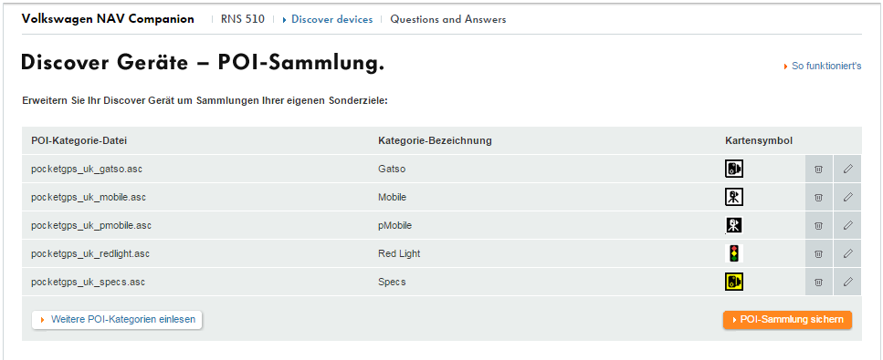

I then followed the instructions for the VW website and downloaded individually the 5 different types of cameras together with Icons. I note that the file created by the VW process gave a .db3 file extension although I note that one of the other contributors on this topic advised in February of this year that the DB file is not recognised in the latest version Columbus and in fact he stated that the VW process creates a self extracting .exe file.

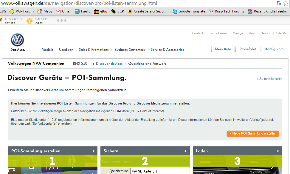

The MIB Columbus you have is called a Discover Pro in VW speak, you need to use the Discover Pro version of the database creator.

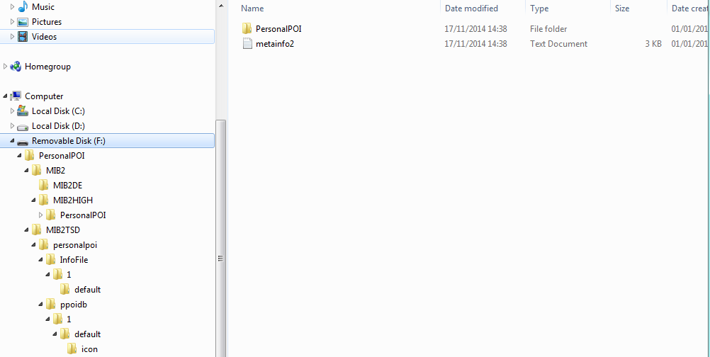

Below are a few screenshots, including what the final SD card should look like. Basically you end up with a zip file that you extract on to the root of the SD card.

Well, as per the farce with the map downloads, Skoda seem to have made a pigs ear of the PersonalPOI creator as well.
Imported .asc format and created everything - the Columbus starts to import them and then flags up an error about 'Invalid Data'. Used exactly the same source files and icons with the VW site and it all worked fine, using the large 44x44 PGPSW icons.

Below I have taken screen shots and also the structure on my SD Card in case you can spot a problem. The only difference I can see from your SD card structure is that under the folder PersonalPOI on the right hand side you have a file labelled "metainfo2" which is a text document whereas mine says "WMPInfo" which is shown as an XML document.. I didn't create that file but do you think it might be stopping the SD card from downloading into Columbus ?

The SD card screenshot is too small so here it is again so we can read it properly.
The metainfo file needs to be there. Why are you trying to import destinations? You just go to settings, map, import personal POIs I thought.

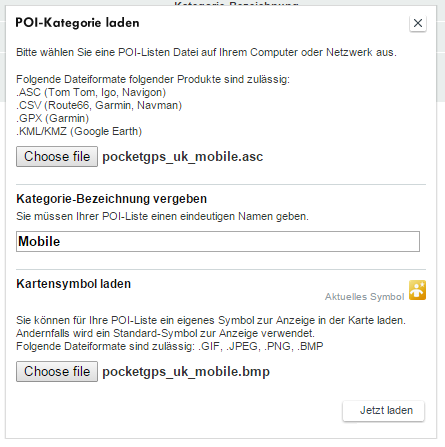

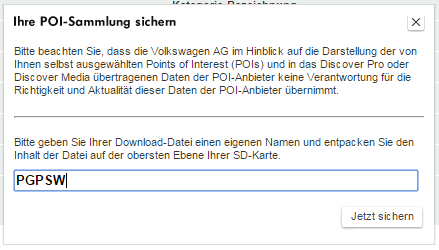

Somebody help please! Can anyone advise how I can get past Andy's screenshot 5. I seem to be doing everything right upto there (even using the same files from PGPSW) and the same naming convention, but when I click the "Jetzt Laden" button, the fields go blank and I get a message advising the session has timed out and that I should start a new session. Tried several times without success. Someone on the Golf forum stated that a "requester" button appears at the bottom left of screenshot 5 to save the your selections to a waiting list, but I haven't seen this (has anyone?).

Problem Solved. Thanks to Andyvee, I tried Chrome for the download. Pleased to say it worked where Firefox, IE and Safari for Windows all failed.
