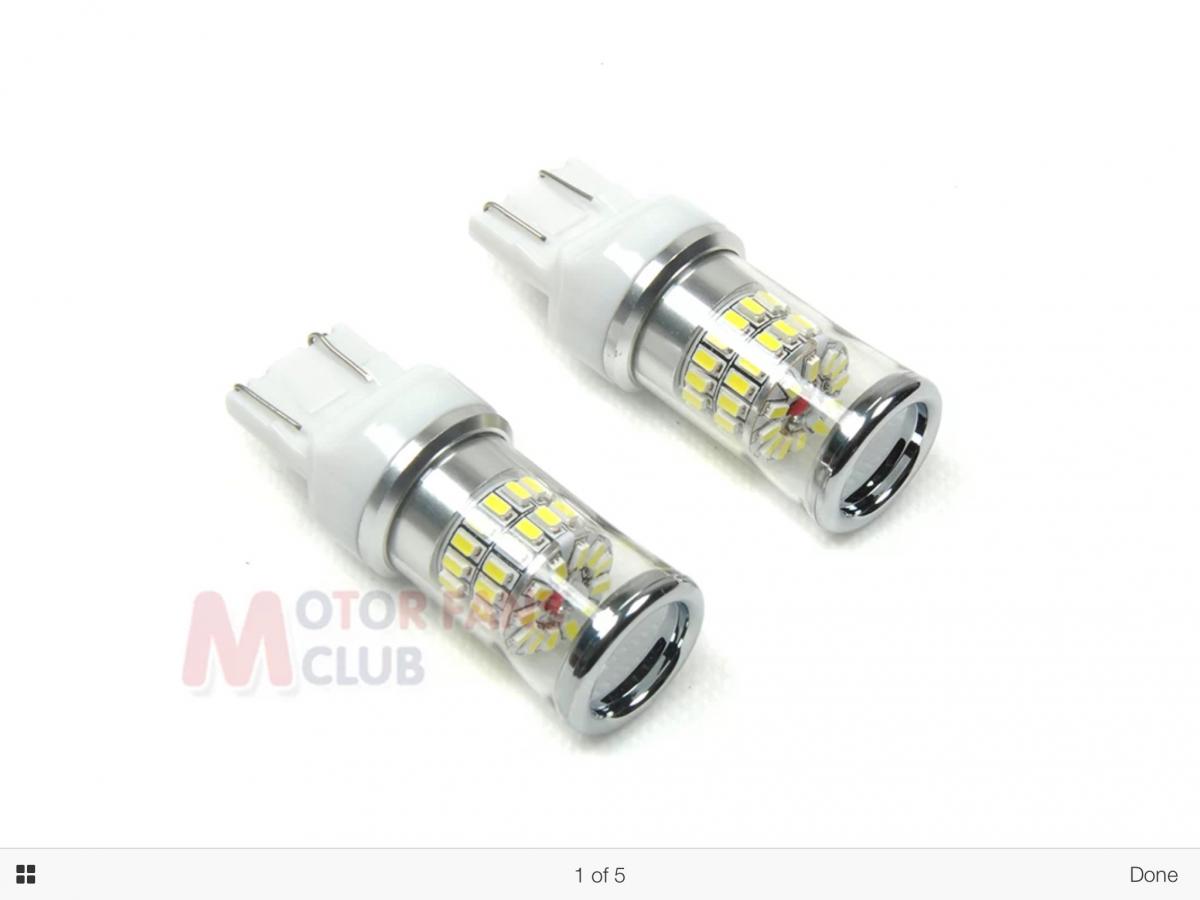

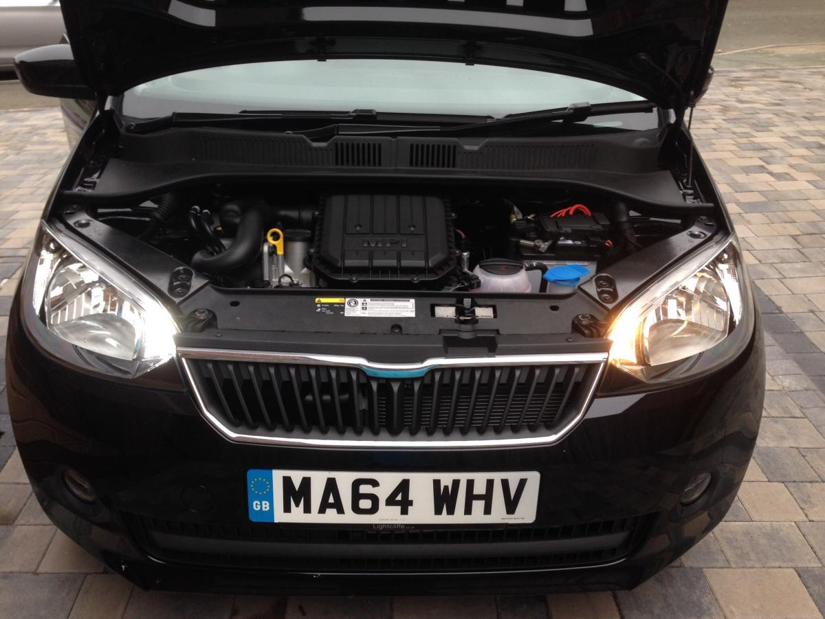

Also whilst I'm here, a question for Johna-23, how the heck did you get your drl's working? :D I think I bought the same ones but they refused to work when I switched to parking lights
Hi Hyphons,
I re-routed two of the wires on the bulbs and used heat shrink on the earth one to insulate the new pathway!!! It is a bit fiddly but use a multimeter to identify the two lives; one is routed wrong and needs to be bent over 180* the others are earths need to go together!
The first image shows the RH changed, very white and very bright!
Hi Hyphons,
