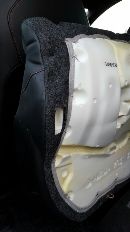

The photo shows the back edge pulled out from under the seat back, i think I am going to need more room than that, so if you can please confirm that the whole seat base comes out.
Sorry I am a bit confused about doing this without breaking something.
Thanks very much
Don't worry I've sorted it.
Lift and push back slightly at the front to release the clips which hold the squab in place, then keep it low - just clear of the clips - and slide it backwards to disengage the clips then lift it out.
Its the same as the Golf 6 and 7.

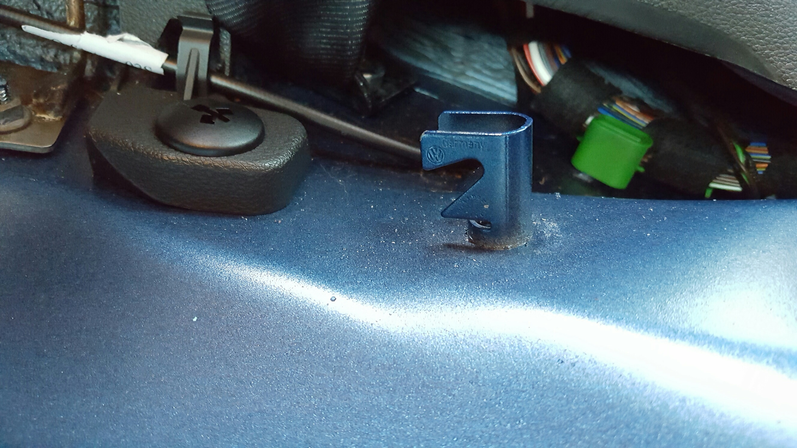

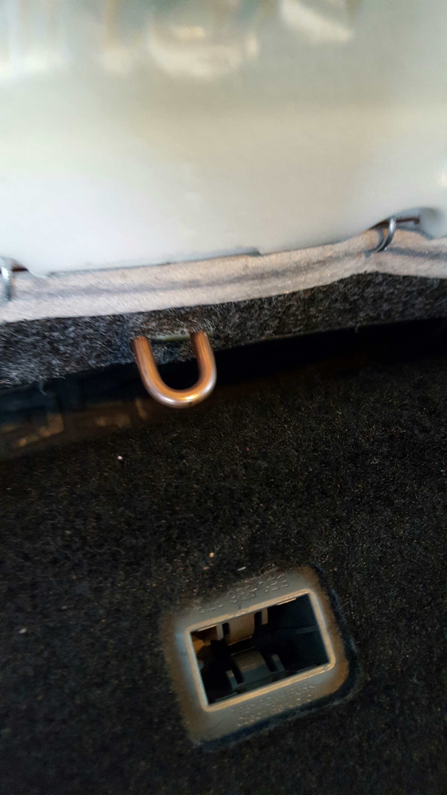

Hi,
I have been tearing my hair out about removing the rear seat squib... and seeing that the dealer said it couldn't be done please find some instructions and pics to help.
I do not provide any guarantee or warranty for the below but it worked for me
1. firstly remove the ISOFix covers
2. remove ISOFix surround... it's like a pull and push... then thread through gap in surround
3. pull sharply up on the front of the squib about 9inch from the end... both sides... this should expose some U clamp wires
4. then push to the rear of the car... downwards and the clips at the rear of the squib should release
This was driving me crazy due to a constant rattle/sliding sound as I went around corners!... so I have now completed the endeavour and released a button and a bead from below! Phew... Hope it's of help to someone else  :-)
