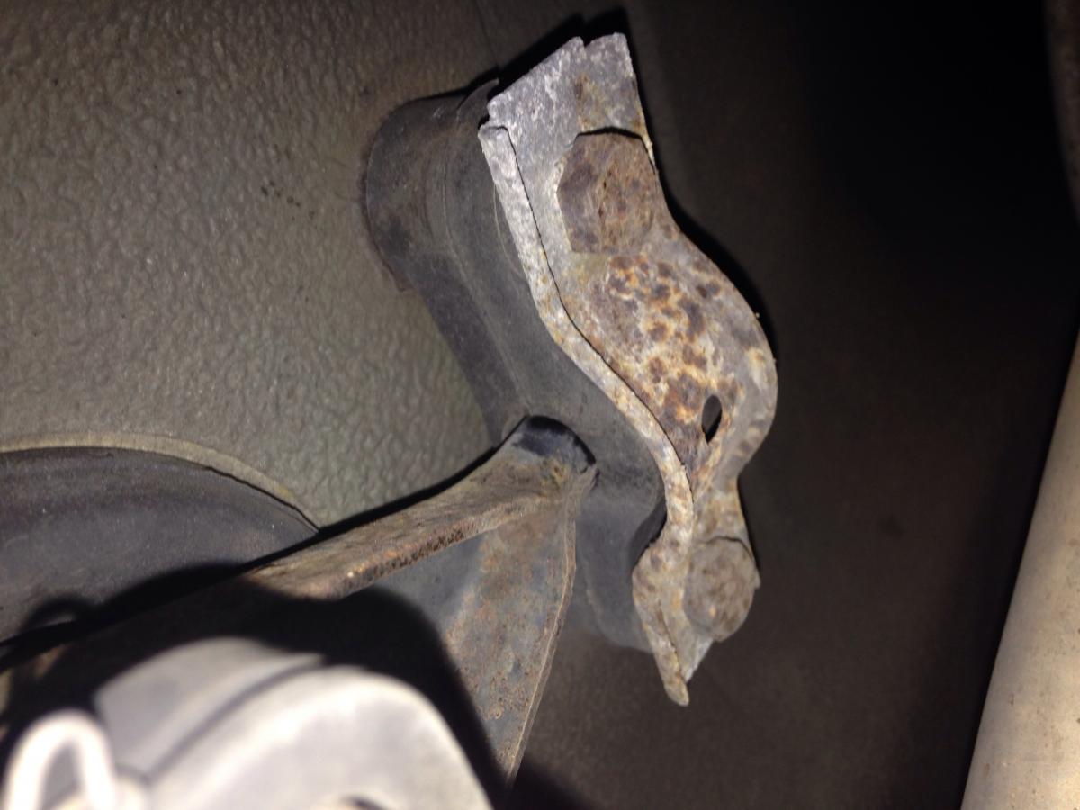

Felicia gear linkage part?
Hi I was wondering wether any could tell me if this rubber bush at the rear of the gear linkage is available. I can't seem to find any where that stocks it. Does anyone know the part number I might ring up skoda. Thanks Alex post-97608-0-57286700-1420050789_thumb.jpg

I used a short piece of 15mm plastic pipe to sleeve the hole and take up the slack worked well clive

6U0711563A
Thanks for your help. If I can't get my hand on the rubber bush I may try the pipe solution
I have 2 used  rubber bushes if you want one happy to send you one, if its better than the one you have send me the price of a pint for it pm me your address Ill send you a piece of pipe as well  Clive
Hi thanks for your help. I managed to find some pipe lying round the workshop. Did the fix this afternoon now it's all good. Thanks for the offer though. Many thanks Alex
