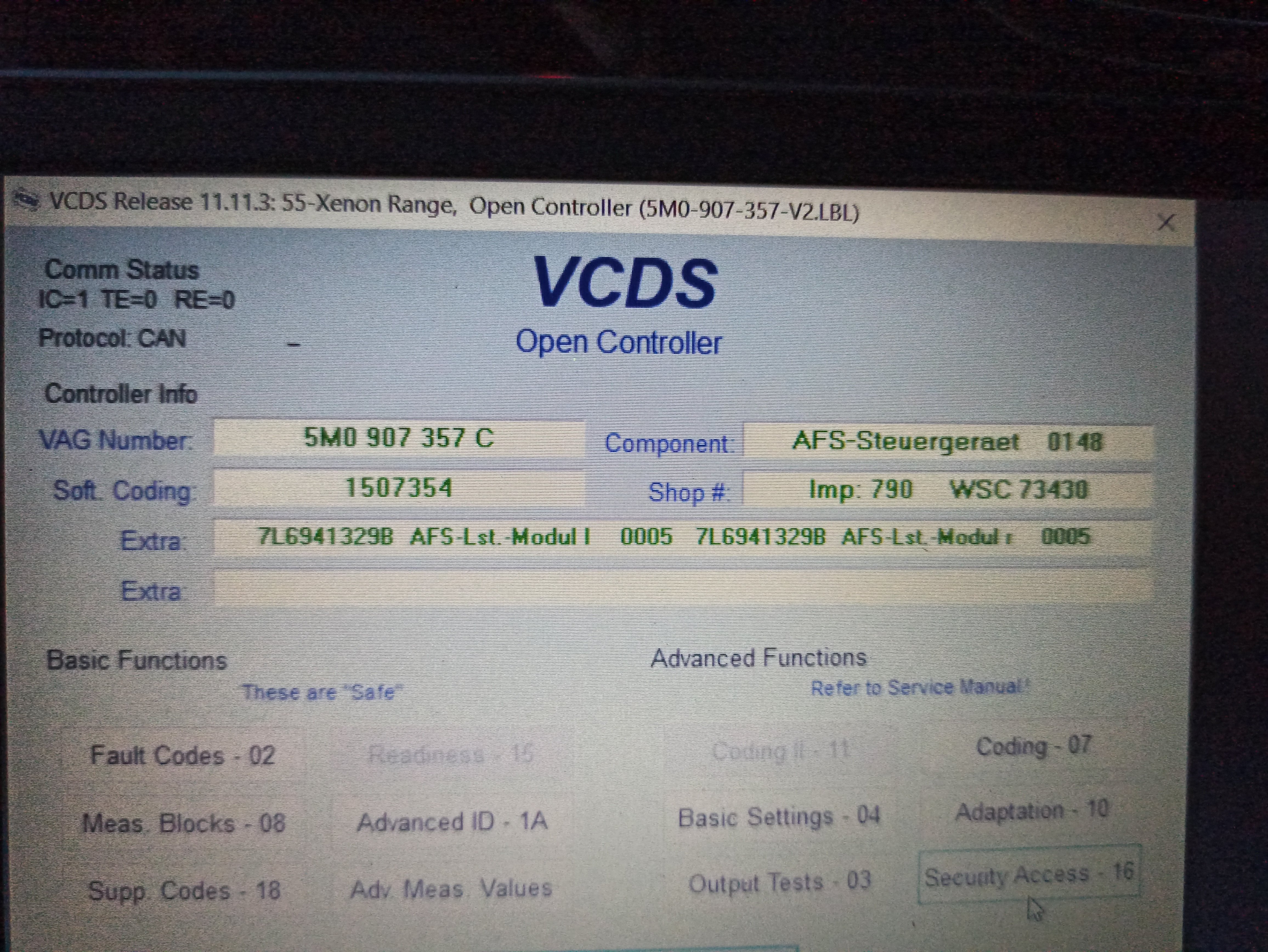

Took the plunge this morning and enabled AFS II 😁👍
I parked in a dark covered car park and put tape on the wall to mark the current position.
Changed the coding, did the basic settings and I think it worked.
I assume nothing shows up in Maxidot menu?
