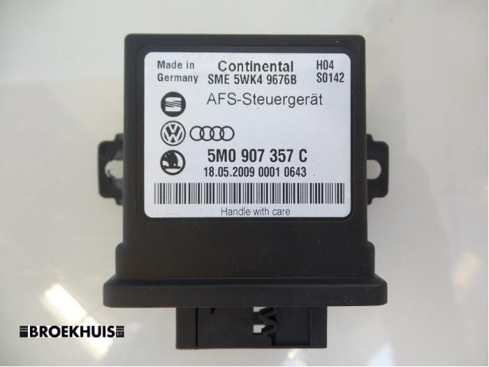

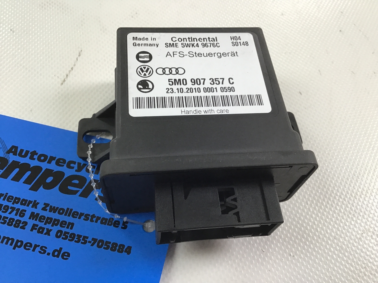

I don't think it's mentioned in the other thread but I believe you require an AFS master which has software version 0148 or later. The version is printed on the sticker on the unit, which is located behind the climate control panel in the dash.
You can see the following two have the same part number but the top one is software 0142 whereas the bottom is 0148
Used Volkswagen Golf VI (5K1) 2.0 TDI 16V Computer lighting module ...
Control Unit VW GOLF VI (5K1) 2.0 R 4motion VW: 5M0907357C VW ...
Ah, ok. No way to view the software version via VCDS or only looking at the module.
VCDS scan will show the software version
