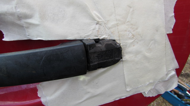

Please does anyone know how to free the rear door outside handle from the door lock mechanism ? I've removed the plastic cover on the rear of the handle (see photo) but it is not the same type as in Rob Clubley's excellent photo sequence.....all advice gratefully received as my patience is at an end after several days struggling with these apallingly designed doors/door cards!
You need to loosen but not remove 2 locating screws to the north east of the 2 big splines that secure the mech. 2 little holes they are and a tx25 and/or tx20, not sure which. Bottom one unscrews til you feel some resistence then stop (roughly 12 full turns). Top one just unscrew til loose, then wiggle the hell out of the barrel from outside, mine took a lot of effort so just persevere. You can wrap a cloth or bit of card round a flathead and try and start it off with a gentle prise but mainly just shake the **** out of it.

No worries, mine left me scratching my head because I'd loosened the retaining screws but it just wouldn't come out. Went back to it next day and persevered more and eventually it came out dead easy.
