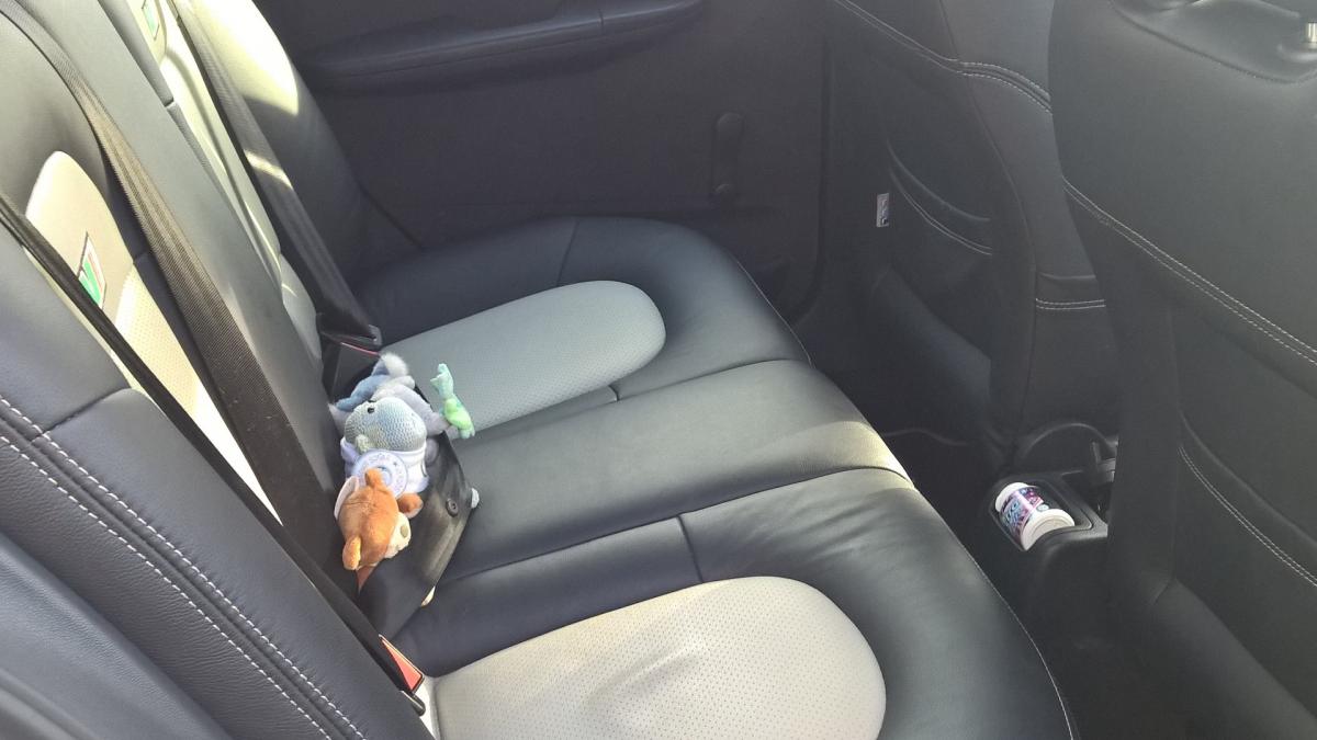

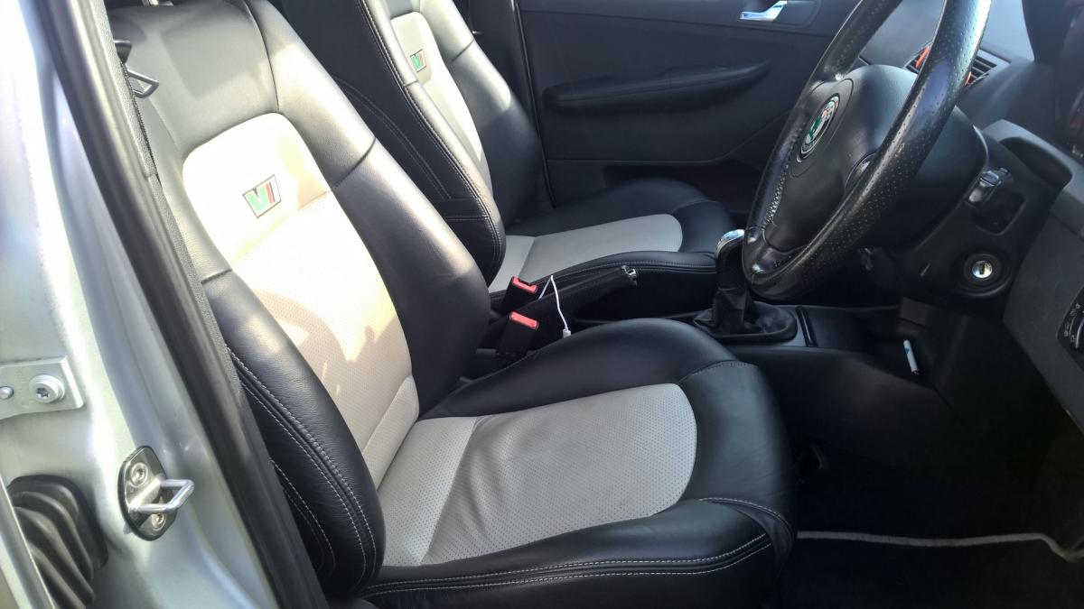

Out with the old seats... and in with the nice new...
LEATHERS!!!
Seat Surgeon Retrims, drove down to Birmingham to pick them up from smithysmoo really nice guy, helped with fitting them for the drive home and WOW, they are so much nicer than the standard ones.
More slippy, but way more comfortable.

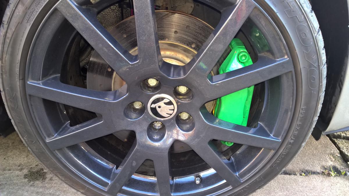

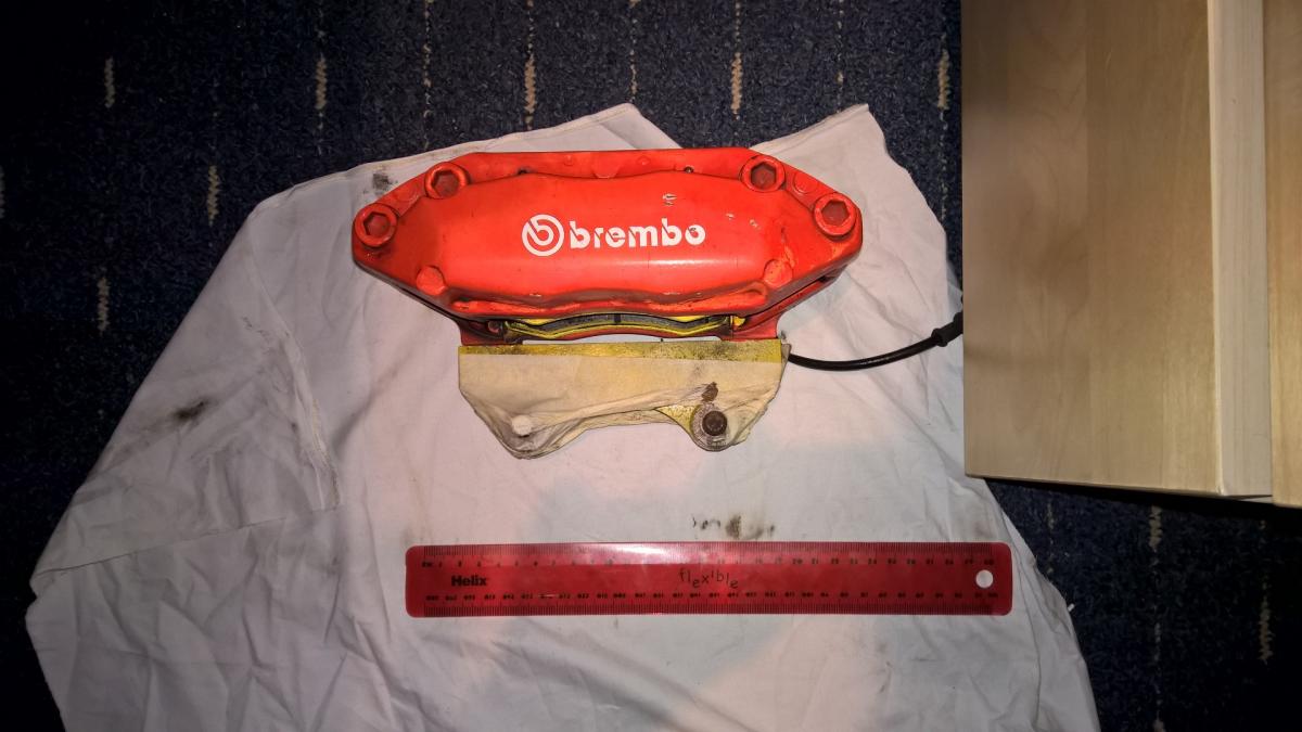

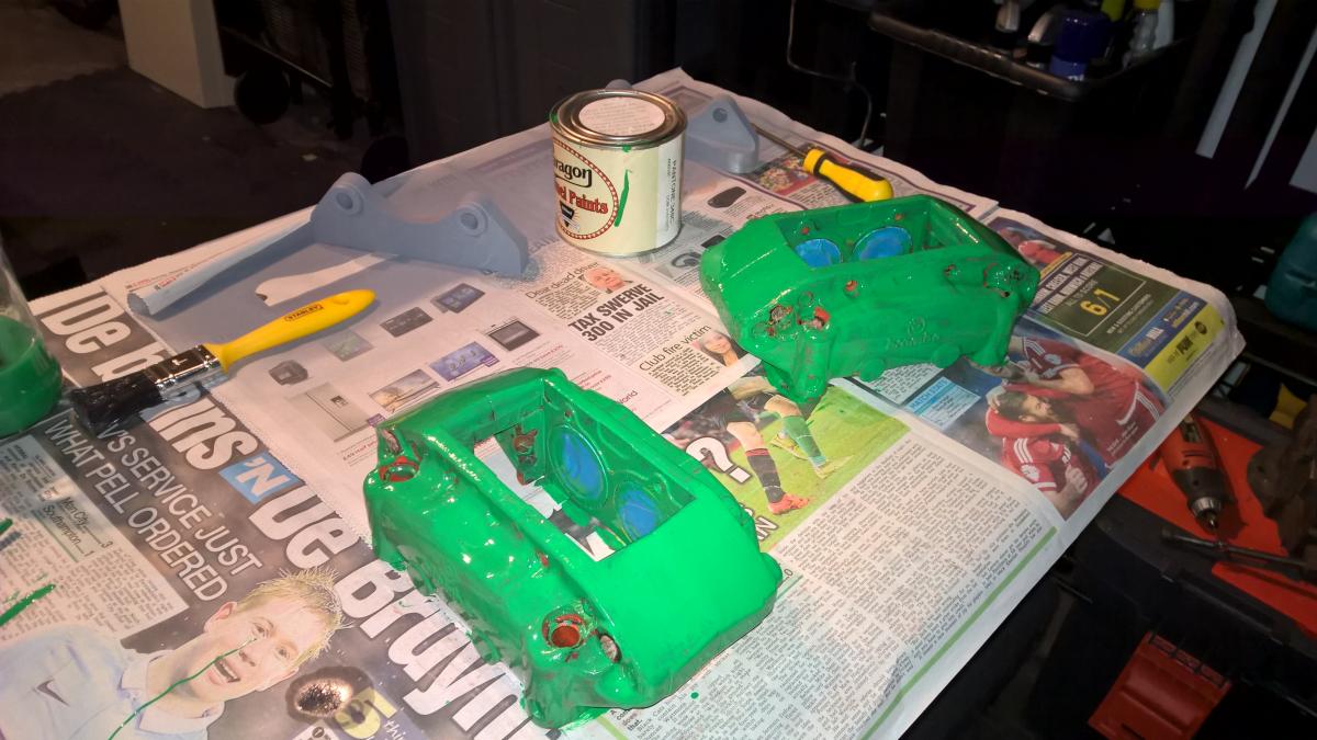

First cost of paint on the brembos now, carriers have been primed not sure to go high temp white or satin black for these.
Edited by Stewpotz

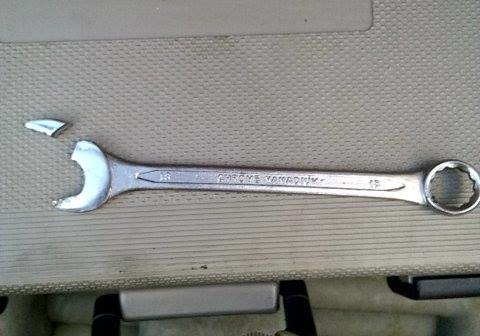

Brembos fitted now, took 4hrs in all, 2.5hrs of that spent with scraped knuckles and swearing to get the lower carrier hub bolt off the 312 on one side (oh and a snapped spanner).
Think one of the pads is sticking slightly as I am getting a faint swiping noise when not braking and a louder rubbing noise when I do step on the pedal.
One hell of a better bite on these, barely even have to press down now to stop!

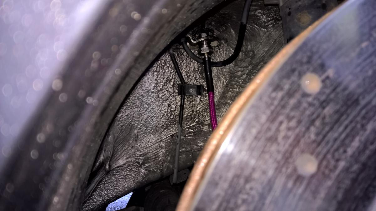

Slight bodge to get the hose to attach to the copper line as square hole and a larger circle hose end. Took for a spin and no leaked that I can see and pedal does not go to the floor indicating air getting in.

Ideally you need to file out the hole in the metal bracket on the inner wing to allow the braided hose to sit flush inside it. Its fiddly but do-able with a round hand file.
The copper brake line sits in much better then and it sits square in the bracket
Thought as much, I just turned the metal clip spring thing upside down to stop the copper pipe coming down but also stops the hose from going up.
Think it has made a full seal anyway as the threads seem to be longer than those on the standard lines

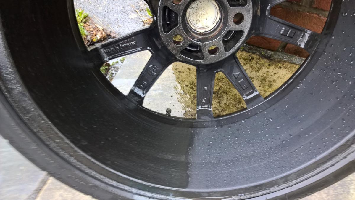

Gave her a good wash, clay and quick BSD as running out of light.  Before this, had all wheels off and gave the arches/hubs a good cleaning.
Can you tell which side of the Alloy still has a load of CV grease...

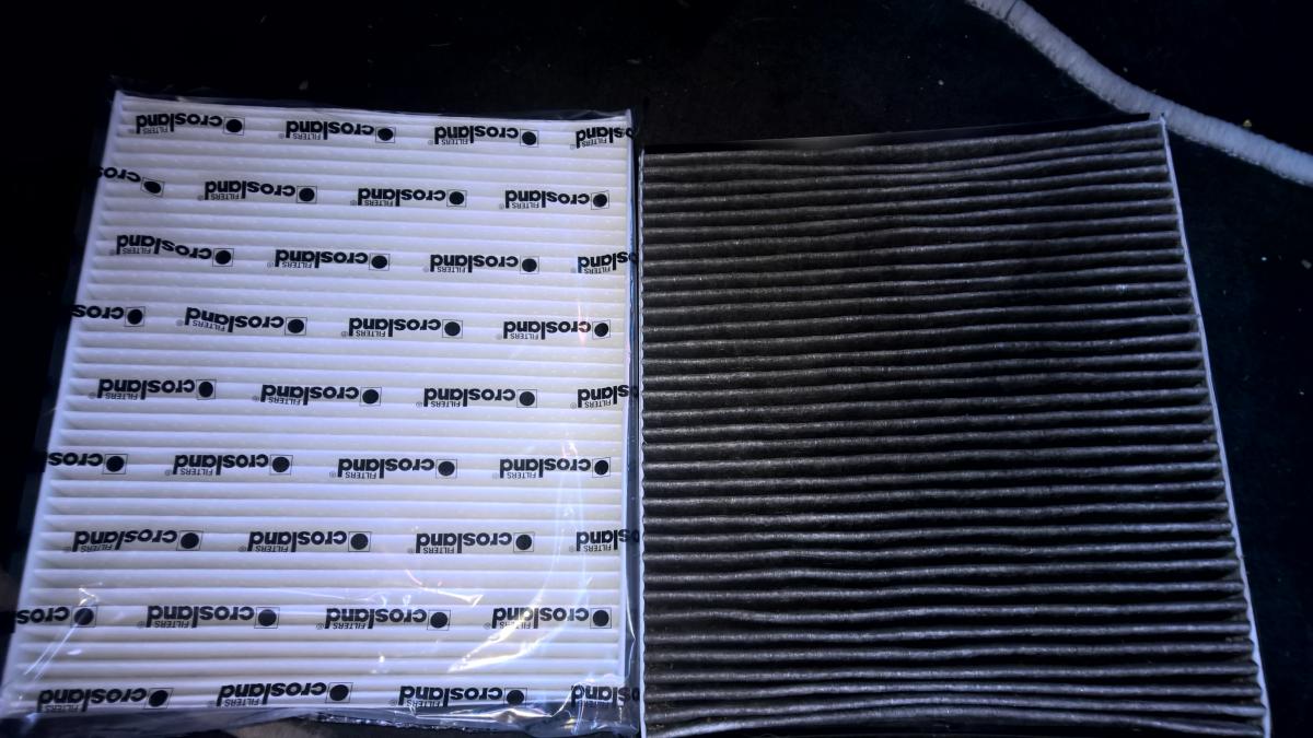

Changed pollen/cabin filter as it hadn't been changed in 67k miles or 8 years...
Not looking too bad for the age, but compared to a new one...

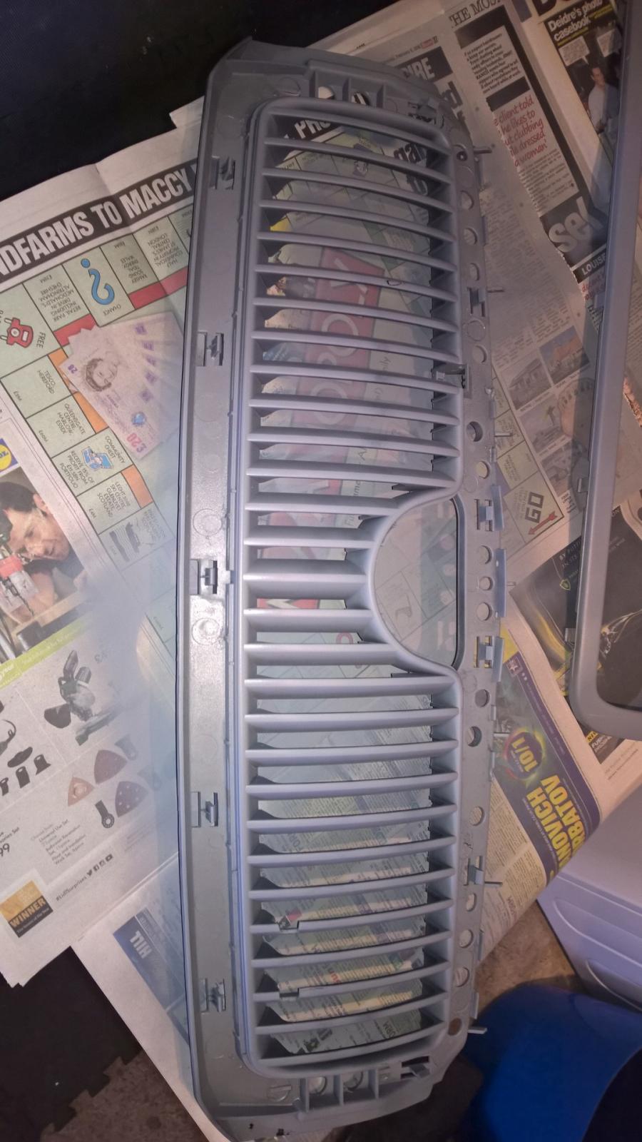

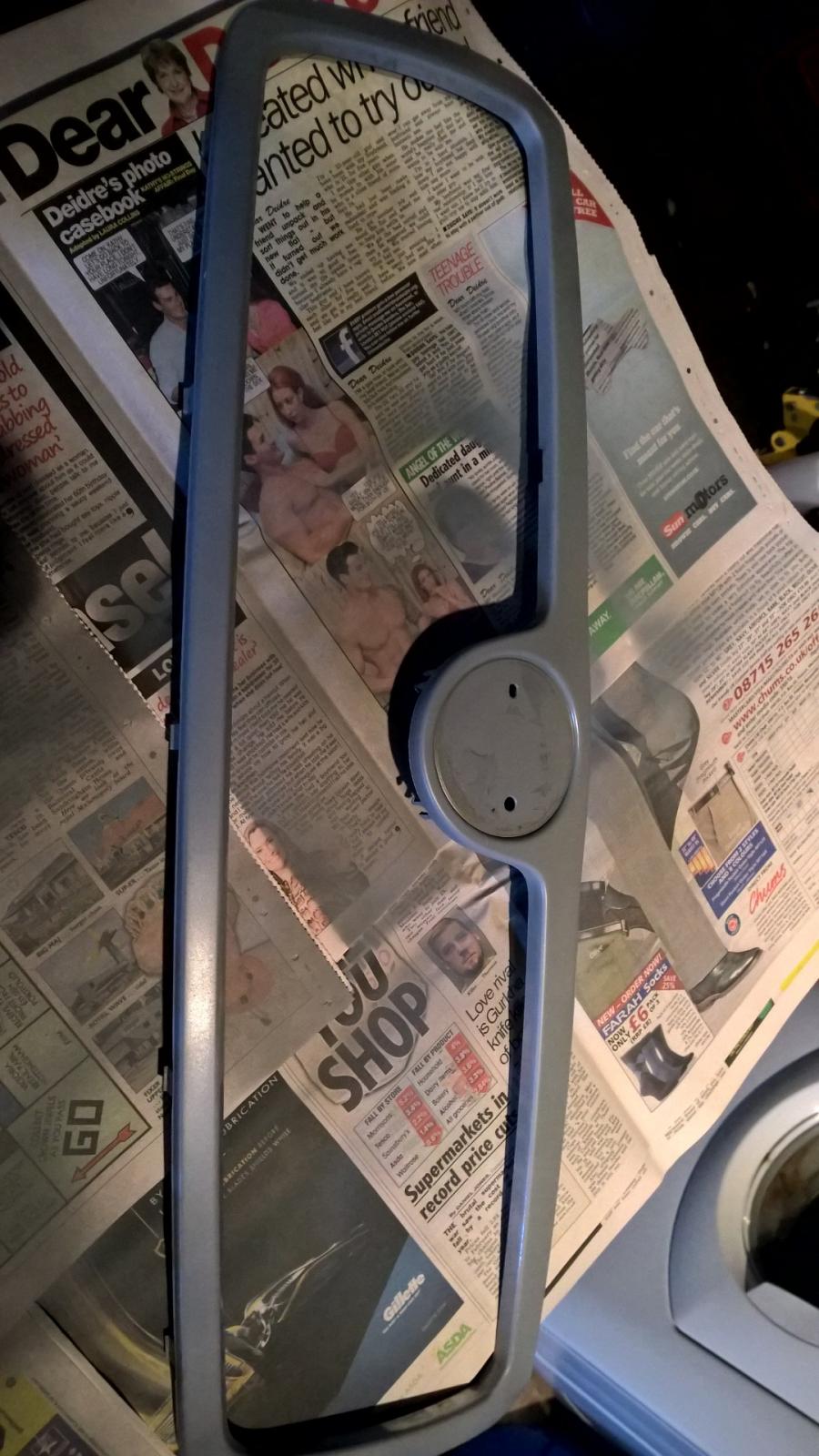

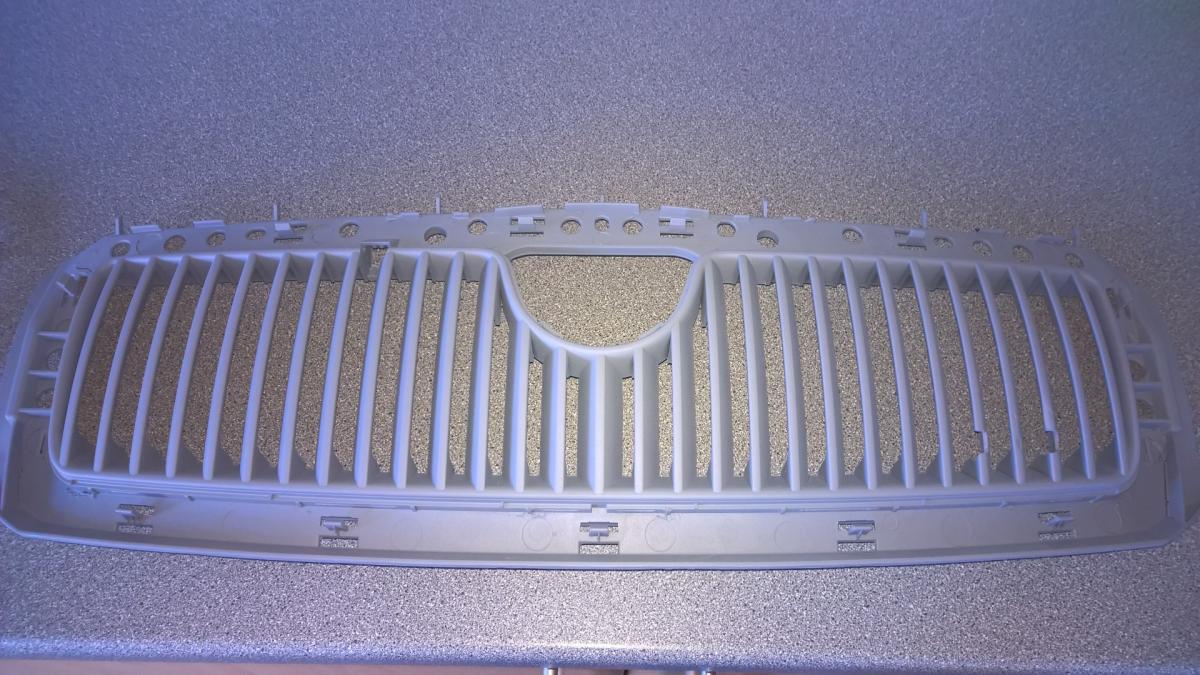

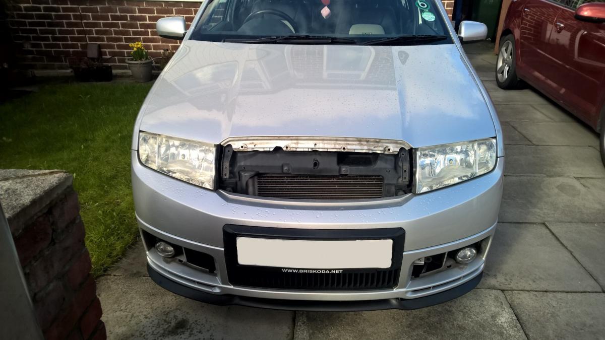

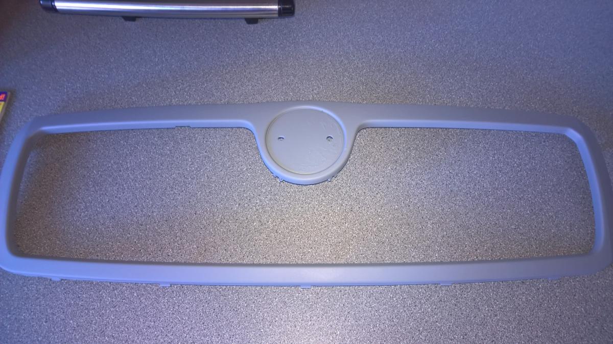

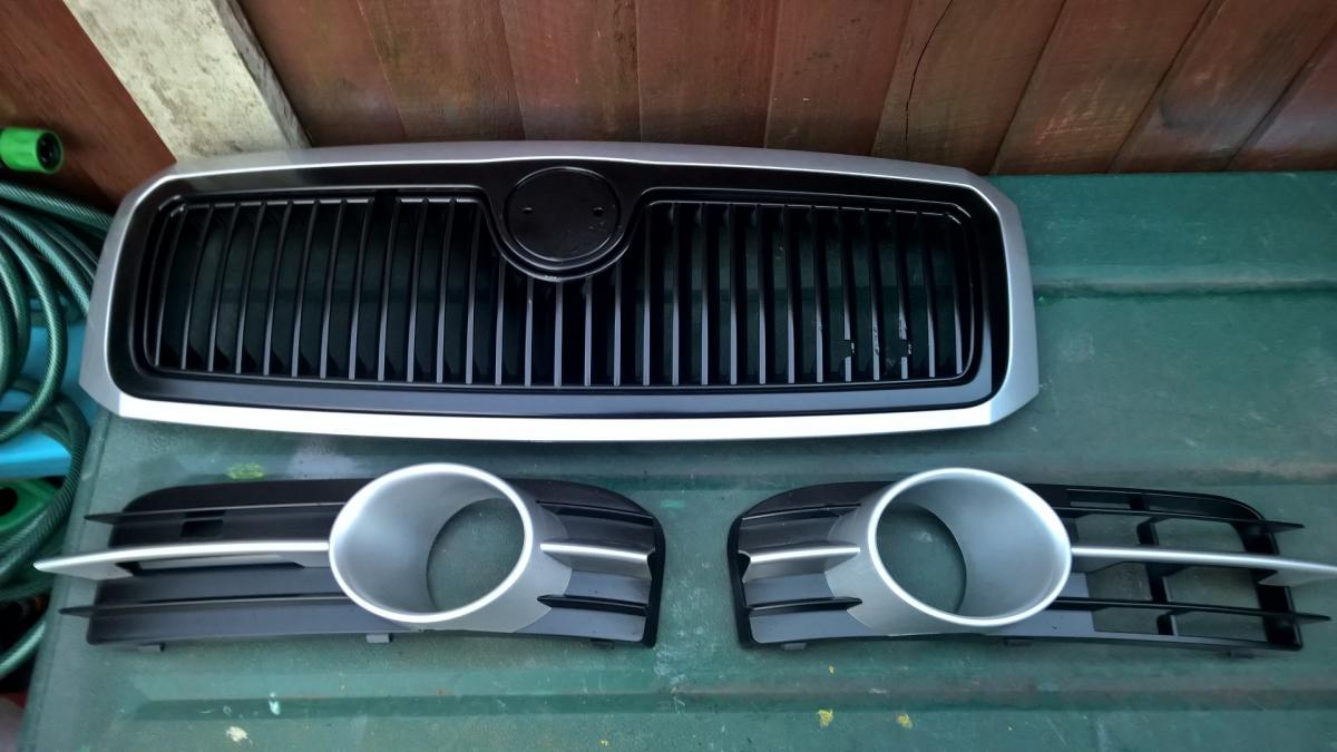

Finally decided to remove my grill and spray the chrome surround.
Also decided to spray the grill its self, after taking a dremel to a couple of the fins to fit my new vRS badge (bolt through)
All primed, left near the radiator to dry overnight before giving it the top coat tomorrow before lacquer on Friday
Also sprayed my fog light surrounds (but forgot to take a picture).

Grill and fog light surrounds now sprayed.
You can see the modification to the grill (which looks very nice with a satin black coating rather than the original) which allows me to fit the MK2 bolt through front vRS badge
New front and rear badges arrived yesterday, so hopefully will remove the paint from the centre of the grill surround tomorrow and fit the new badges.

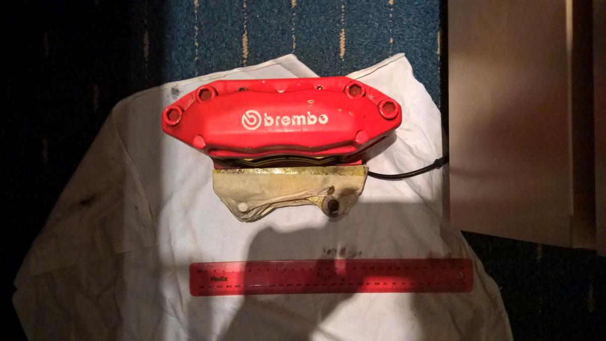

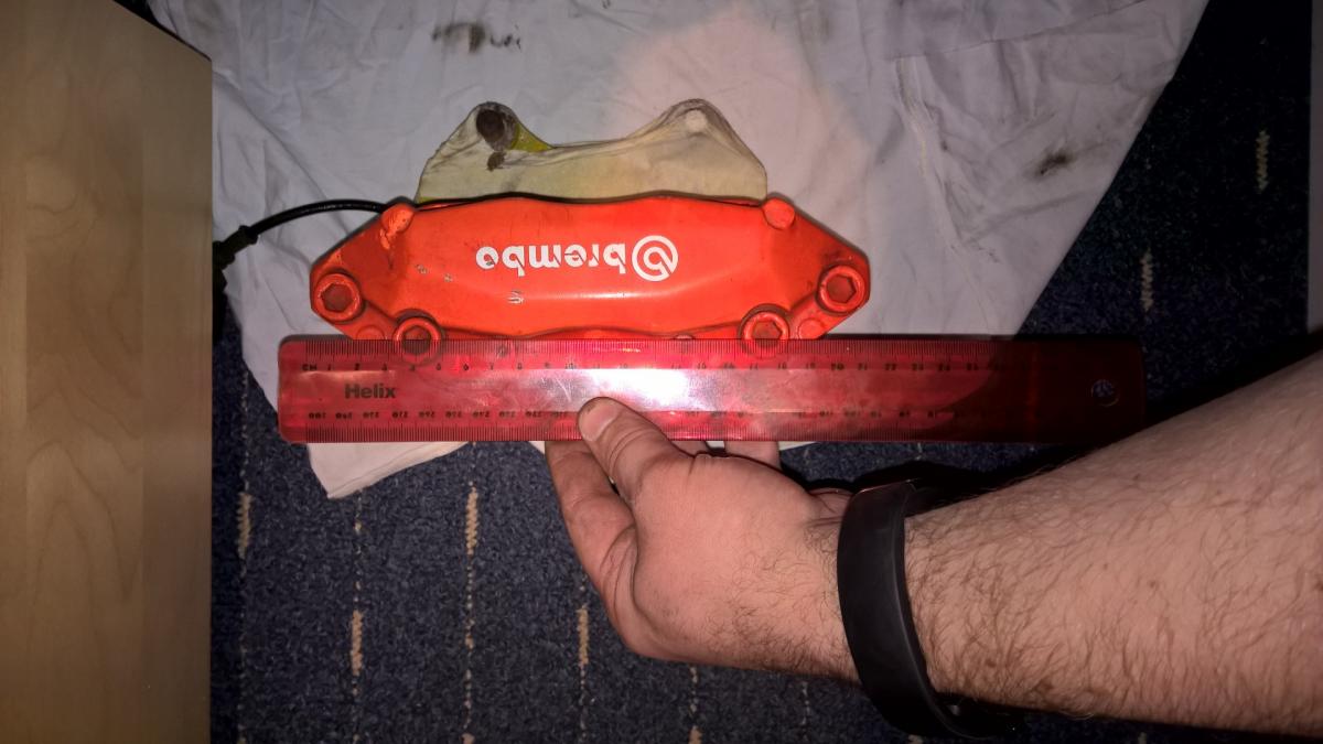

So, went out to change LCR brembos back to 288mm stock so I can refurb and paint.
Removing took 10 mins max from jacking up to caliper in my hands.
Fitting was a ballache as couldn't figure out how the pads sat in the shims... Finally figured it out after an hour of shouting and swearing.
And now the big OOOPS!
brembo brake line fittings are not the same as standard!
Trying to get my custom HEL lines to fit the stock brakes would not work!
LCR look like a m10x1.0 where as the banjo bolt fitting looks to be the same m10 but with a much greater pitch (1.25 at least).
So after much fluid everywhere, all over me, the drive and the calipers (which has ruined the paint) I admitted defeat and refitted the brembos and will have to look into getting some stock lines and banjo bolts :(.

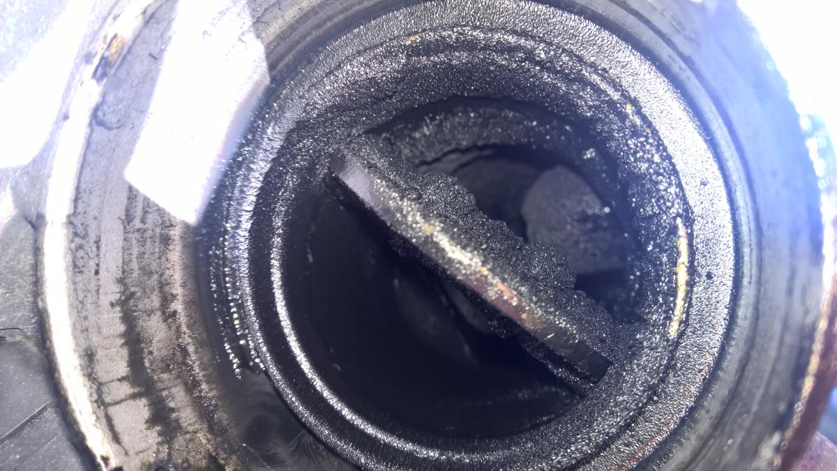

Also had a look at my egr as think it needs cleaning... Yep!

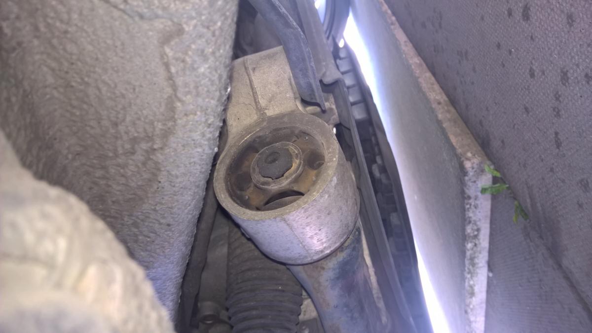

Also had a look at my console bushes as it had started to make squeak noises now and then...post-108825-0-70008200-1461168159_thumb.jpg
Are these the voided fabia ones?
Edited by Stewpotz
Yep they sue look like it, however they look different to the ones I had. Maybe there the new x shaped ones from the octavia I believe.
