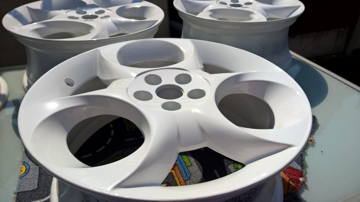

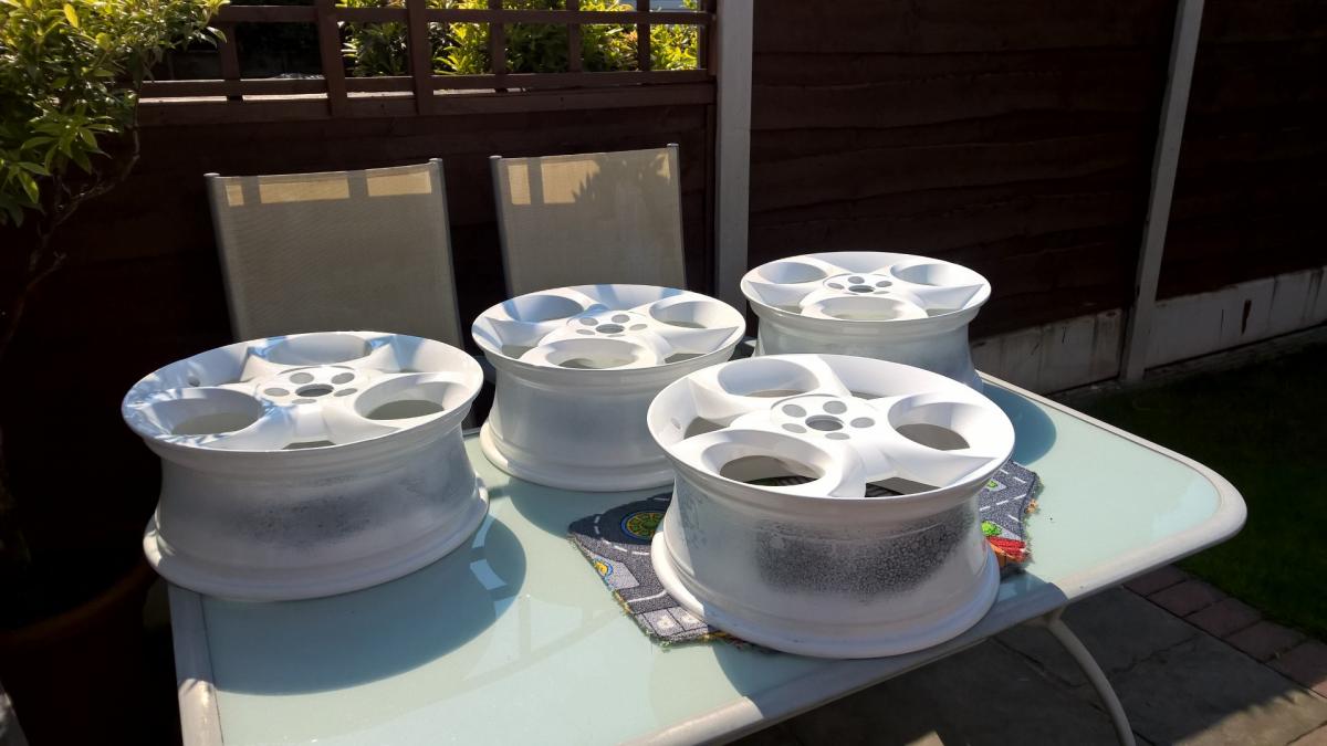

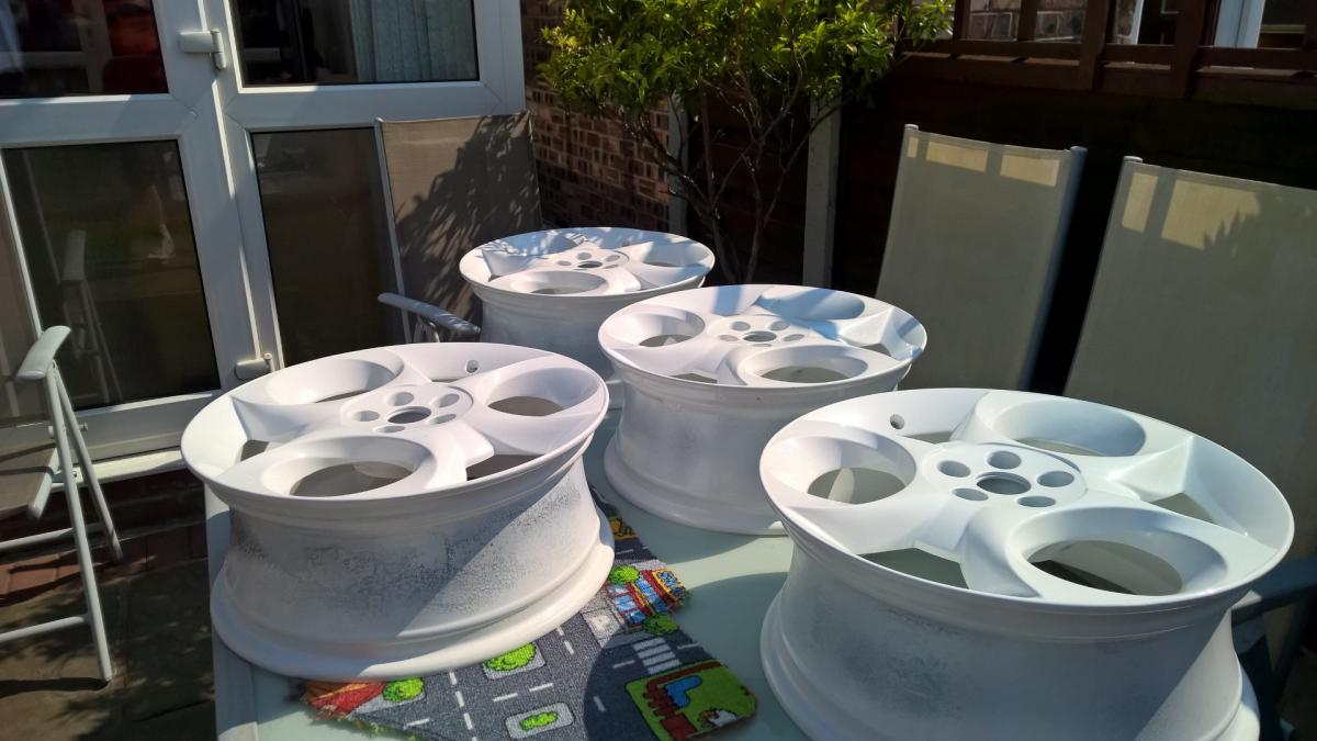

Ordered some carbon collective platinum wheels to coat the alfas before I finally get them sorted (hopefully tomorrow if I get it off work).
A little sure does go a long way, I gave the faces and the barrels 3 coats each and still have around 1/3 of the bottle left.

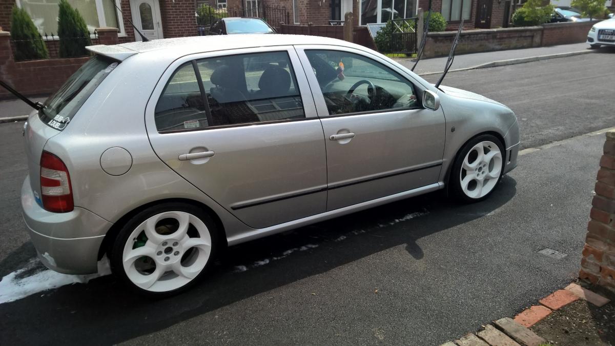

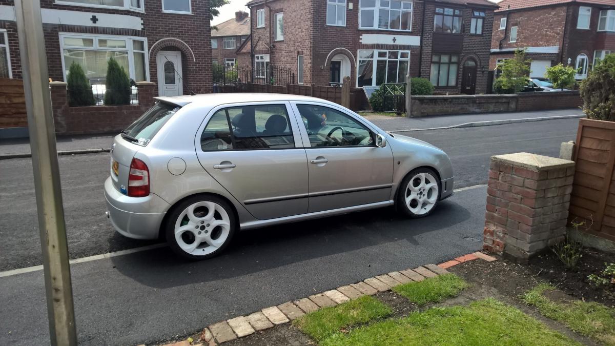

And the Supersports are finally on!!!!!!!
I do like the look but we have a major problem...............
They do not go over brembo 4 pots!!
Need a minimum of 25mm spacer which pushes it out waaay too far!
absolutely fine on stock (or maybe 312mm) but I have fitted with 10mm spacers up front just to be sure.
Think these will have to go soon as I cant be without my awesome stopping power, almost crashed when i put stock 288mm back on as I am used to being able to just flex my big toe and the car will pretty much stop dead, now though
awe they look nice man, and original too, wont be many with these :P
awe they look nice man, and original too, wont be many with these :p
Think I have seen 1 other on here (plus the guy who I got them from), so 2 in total.

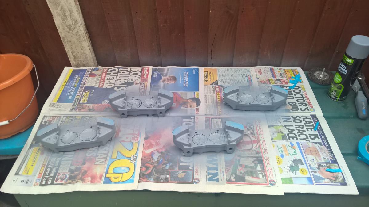

Anyway, this gave me time to have a look at the brembos before refitting.
Left both callipers submerged in brake fluid for 2 days, agitating every few hours during the day.
Most of the green enamel paint was gone as well as the vht red paint, yellow powder coat and the base red powder coat (guy who had them before certainly couldn't make his mind up ;))
Then used some of my starchem paint stripper to get down through the rest of the paint/powder then attacked it with a combination of a wire drill attachment and my dremel to get as much off as possible, and anything which wouldn't budge had its edges smoothed.
Noticed a small amount of fluid leaking from between the 2 pieces which turned out to be a worn o-ring inside, from research online this is not a user replaceable part and brembo do not sell them separately...£2.99 o-ring set from Maplin and there is the perfect one included (20 in fact!)
Whilst in 2 pieces, I removed all 8 pad guides as they were causing the pads to stick, the T27 screws were well and truly stuck, but a combination of a dremel cutting disk, hammer and screwdriver and impact driver got then all out.
Decided that I wasn't going to deal with this again at a later date, so every hole was drilled out to 6.3mm, and helicoiled so if is now stainless steel screw into a stainless thread.

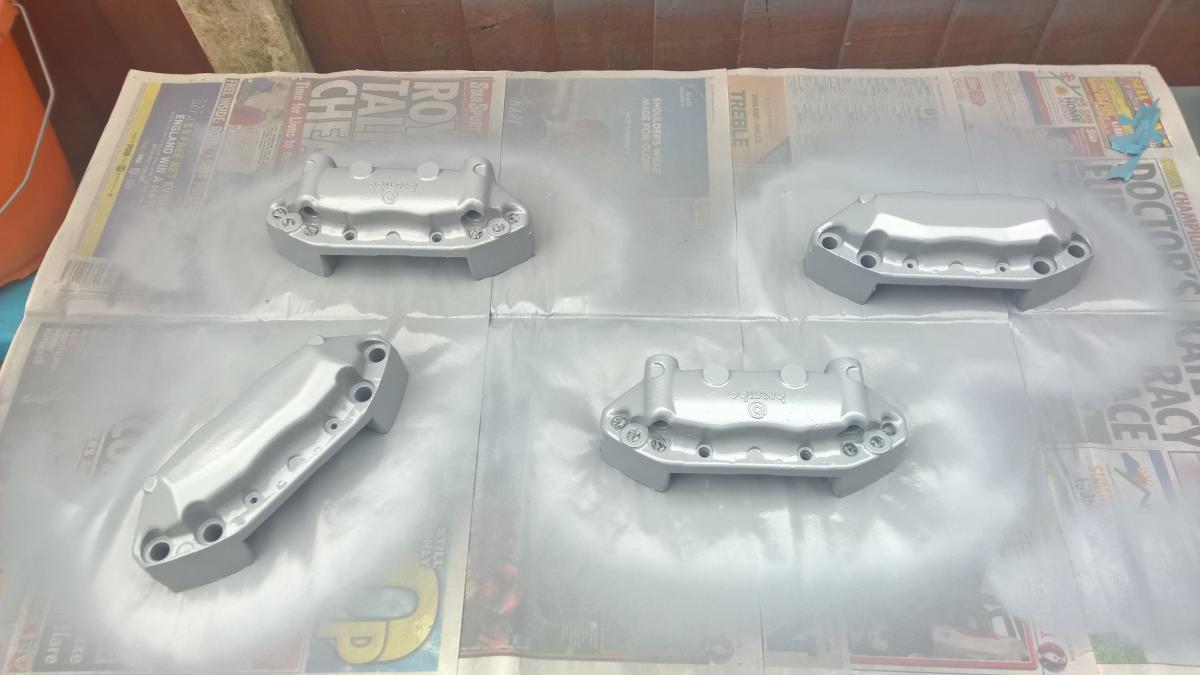

Each half has now been etch primed currently drying for 48-72 hours to be sure it is fully hard.
Went through 2 400ml cans to do all parts, including the mounting brackets.
Edited by Stewpotz
Pics from etch primer stage

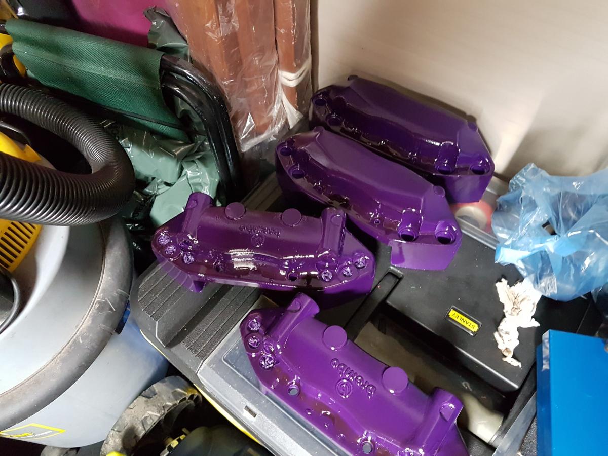

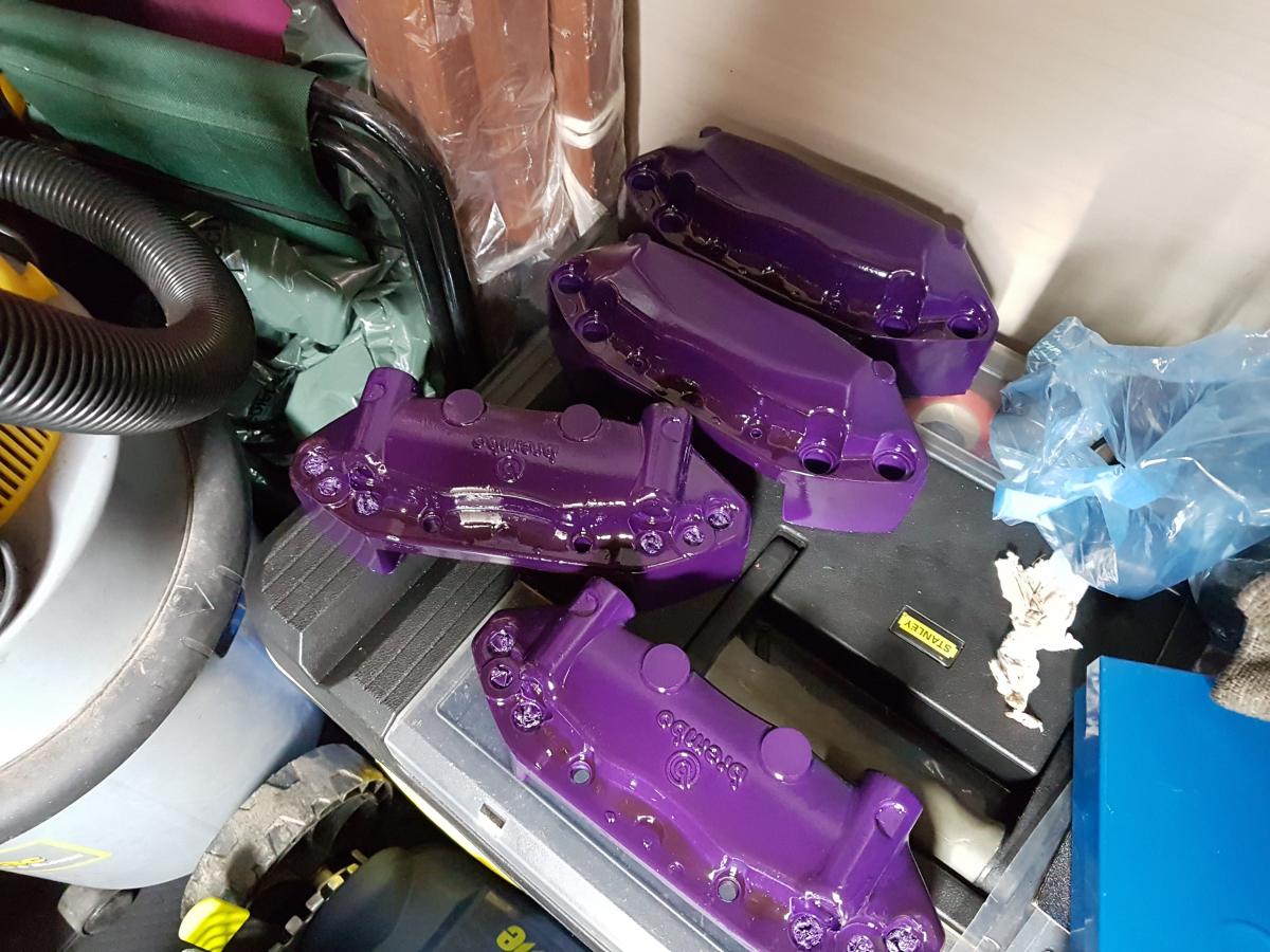

Left them until today when i gave them their topcoat....
Candy Purple.  Leaving them the same 48-72 hours before giving them a good lacquer coating.

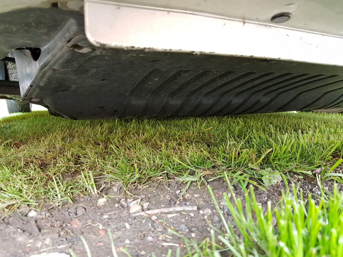

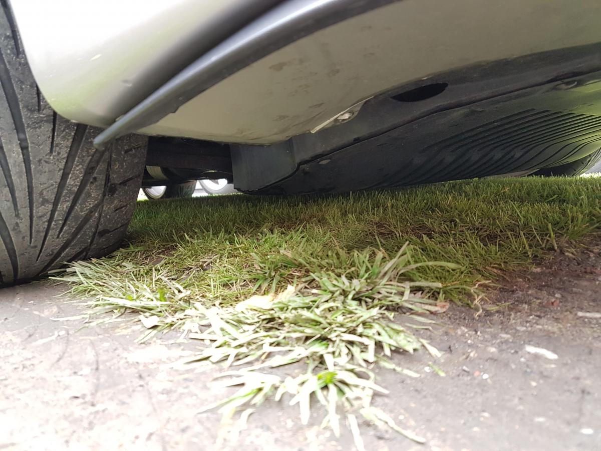

In the meantime, had a look under the front bumper.........
Plenty of room ;)
