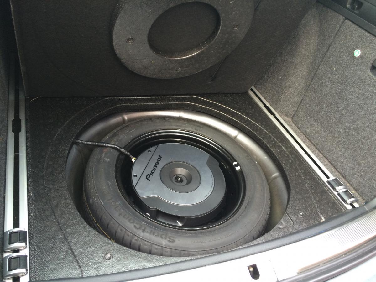

I went for the pioneer ts-wx610a. It literally fits inside the spare wheel, then you put your jack and tools inside the bag provided and put then in the side cupboard. It really is an invisible install.
I bought from a German seller on eBay. Quicker delivery, and much cheaper than buying from a UK. Looks like £170 will get you one, as £ very strong against € at the mo.
If then cost me £100 to get someone to fit it for me. There's a lot of trim that needs to be removed, as you need to run cables from the front to the back of the car - so I left it to the experts. There's a wired remote control as well, which I had them route through into the little driver cubby by my knee.
It's great for the money.
I bought mine after having the same recommendation from Jake and it makes the sound so much better as the speakers can handle to mid/upper range and the sub the bass. I have added a picture of mine below which is exactly the same active sub as Jake's. If your anywhere near Manchester you are welcome to come and have a listen to mine if you like...
