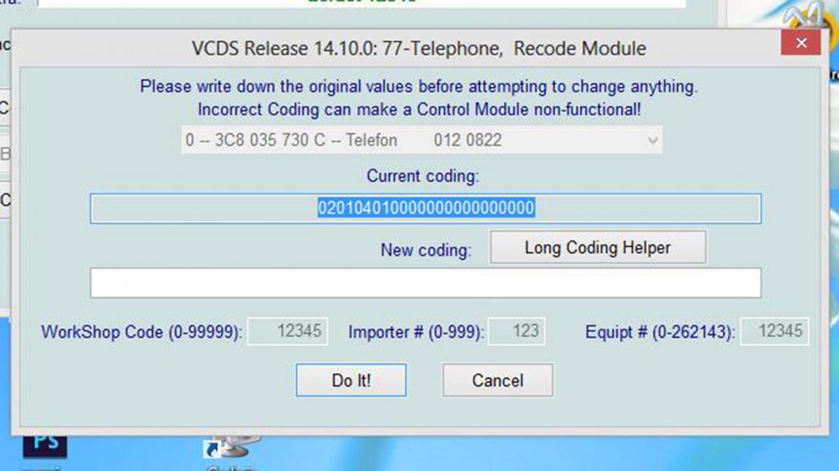

I have used my vcds to try to find a reson why my bluetooth audio has stopped working. I got this
13636352 - Control module not coded
          U1013 00 [009] - -
          Confirmed - Tested Since Memory Clear
             Freeze Frame:
                    Fault Status: 00000001
                    Fault Priority: 4
                    Fault Frequency: 1
                    Reset counter: 94
                    Mileage: 68724 km
                    Date: 2014.12.12
                    Time: 14:02:40#
I looked on Ross tech wiki and said it could be programmed wrong. Anyone have a Columbus working with bluetooth phone and audio (iphone 5 or 6) please that would share their long code?
Here is my code now
Any help so much appreciated :)

I can't see anything on media about Bluetooth audio. There used to be something where I could add it on my maxidot and that's gone. The settings of media and phone show nothing so it is really weird.
Deleted all the phone memory and reset phone and media on headset. Faded with vcds and deleted paired device on phone. One of them sorted it as it now works :)
