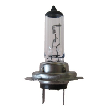

The difference between a halogen and hid is this.
A halogen has a filament and is gas filled. The filament provides the light.

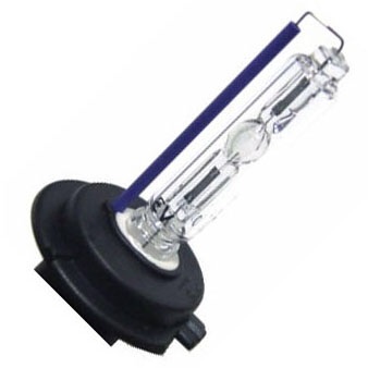

A HID has an arc providing the light.
They work on a completely different principle. The hids also require a ballast, they arent just a straight swap like a halogen. But are provided in kits so are pretty much plug and play.
