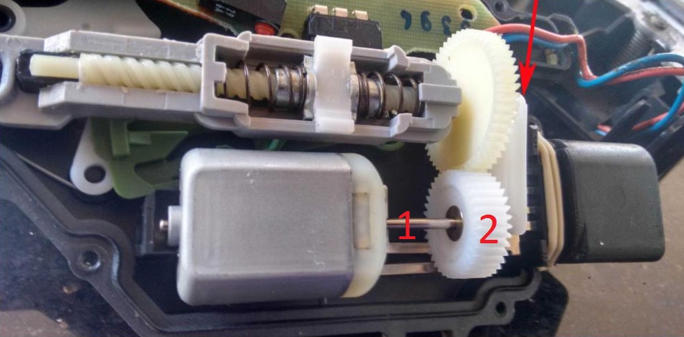

SOLVED!
After fixing the issue with interior lighting (you can find it here), I started fixing issues mentioned in OP.
The problem is following (my English is not very best so excuse me if I miss-use some of the terms in description):
The electro-motor was partially faulty. Its axle (no.1 on the pic) was spinning properly but connection (tightness) between it and the toothed wheel (no. 2 on the pic) on it was loose and it did not have enough strength to properly move the lock mechanism and to trigger the switch which informs the CCM about lock position. I fixed this by adding some glue to improve tightness between these two and now it works like a charm.
BTW. My hands were too dirty to take pictures so I used one found here as the lock mechanisms are the same at this part.
Hope someone will find this useful.
