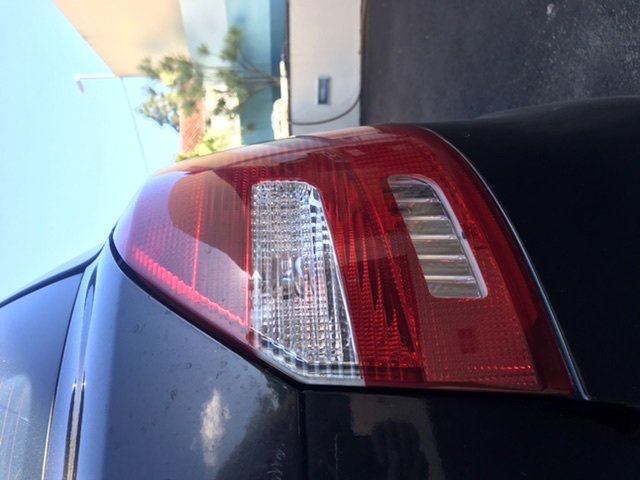

Sorry for the revival but I’ve found that even after the osram diadem there was a reasonable amount of orange showing but if you wrap the bulb connector, which is orange, with some aluminum tape the orange color is almost non existent
