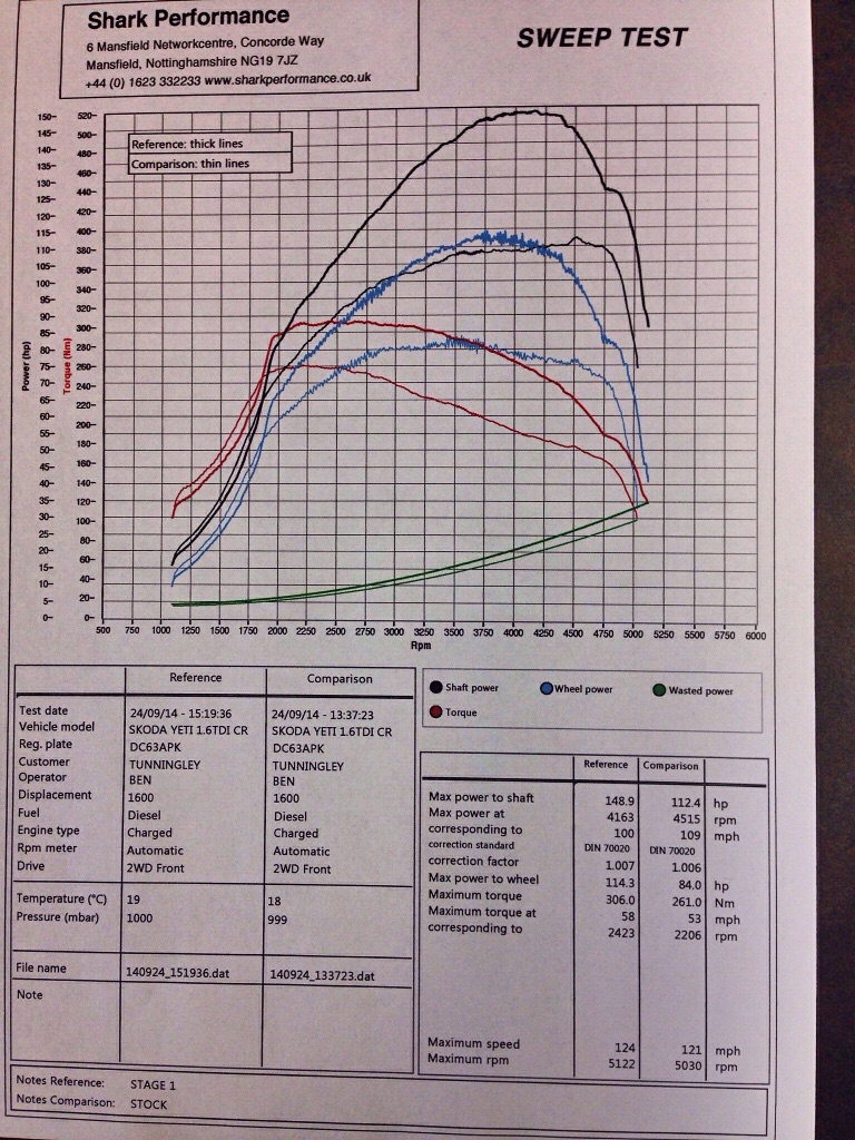

149bhp and 306Nm on a 1.6tdi stage1 from Shark Performance is even better ;)

Don't forget your other goodies which got you up there, Darrell, otherwise everyone will be wanting 148 just from the remap :)
That was before everything else though, all the other mods came after the stage1 map in prep for the stage2 :) the Yeti does have a bigger intercooler as standard which made a difference on the stage1 letting us see the 149bhp. I think the Fabia with the 1.6tdi gets to 135bhp on a Shark state1 if I'm remembering right, but an intercooler + map would get you up near 150bhp which is very nice result :)
That's mental. Does this affect the life of the DPF?
I haven't noticed any change in terms of regens, so it doesn't seem to effect the DPF at all, the Shark map is a very clean burning one as shown on cars without DPF's producing very little, if any, smoke.
